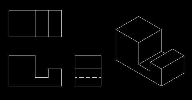

ReMark Posted January 23, 2017 Share Posted January 23, 2017 (edited) Have you tried disabling everything but Windows and AutoCAD? Maybe something running in the background like your antivirus program and/or your browser is slowing things down although it is my opinion your laptop really isn't up to the task of doing anything more than a simple 3D layout. You never provided the model name/number so I don't know what you are running for a graphics chip. The fact you only have 4GB of ram doesn't help either. Who thought this laptop was good for interior design work and 3D? By the way, do you have hardware acceleration enabled? To draw in 2D isometric you have to first invoke the SNAP command then choose the STYLE option. Next type "I" for Isometric and accept the default re: vertical spacing. Press the F9 key to disable the SNAP vertical spacing setting then use the F5 key to toggle the between the three standard isoplanes of top, right and left. You'll know if you are in isometric mode if the crosshairs are at an angle and they are red and green colored. Have you ever drawn an isometric view of anything by hand? You'll have to create the isometric view of each object (building, furniture, equipment, etc.) based off of information taken from the standard top, front and/or side views of the object. See example below. Edited January 23, 2017 by ReMark Quote Link to comment Share on other sites More sharing options...

ReMark Posted January 23, 2017 Share Posted January 23, 2017 Depends on what you are drawing. The vertical lines shown in my example above should be drawn using either the left or right isoplane. And keep in mind that you'll need to use the ELLIPSE command with the ISOCIRCLE option to draw anything circular. Quote Link to comment Share on other sites More sharing options...
wonderpriya Posted January 23, 2017 Author Share Posted January 23, 2017 How do I make it exactly 30 degrees? Quote Link to comment Share on other sites More sharing options...
ReMark Posted January 23, 2017 Share Posted January 23, 2017 How do I make it exactly 30 degrees? That's what using isoplanes is all about; to keep your geometry at the proper angle(s). Quote Link to comment Share on other sites More sharing options...

ReMark Posted January 23, 2017 Share Posted January 23, 2017 Actually where is the isoplane command? There is no ISOPLANE command. I explained how to draw in 2D isometric in AutoCAD back in post #45. Re: SNAP command. Quote Link to comment Share on other sites More sharing options...
wonderpriya Posted January 23, 2017 Author Share Posted January 23, 2017 Is it like this. https://www.dropbox.com/s/z1coxr67ug1jy9p/restaurant_2disometric.dwg?dl=0 Quote Link to comment Share on other sites More sharing options...
ReMark Posted January 23, 2017 Share Posted January 23, 2017 Is it like this. https://www.dropbox.com/s/z1coxr67ug1jy9p/restaurant_2disometric.dwg?dl=0 Yes. And turn off the grid. You don't need it. Quote Link to comment Share on other sites More sharing options...
wonderpriya Posted January 23, 2017 Author Share Posted January 23, 2017 Like I followed the axis and did it but in a youtube tutorial he did it without following the axis. Like he drew 30 degrees just like that. How is that? Quote Link to comment Share on other sites More sharing options...
ReMark Posted January 23, 2017 Share Posted January 23, 2017 I don't know what tutorial you viewed or who "he" is. Yes, you can draw a line at 30 degrees, or at any other angle you can think of by either inputting the distance and angle directly on the command line or by making use of a feature called Polar Tracking (the F10 key - restricts lines to specific angles). However, since you are actually creating a 2D isometric in my opinion it would be better for you to use the three pre-set standard isoplanes that AutoCAD gives the user. It is quick and it is easy. How much AutoCAD training have you received? Quote Link to comment Share on other sites More sharing options...
