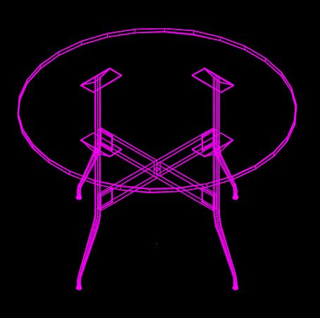

ReMark Posted January 21, 2017 Posted January 21, 2017 OK. Let's talk about some of your objects. This table is comprised of 1043 3D faces. It really should be a single 3D solid model. If you have ten of these tables in your drawing that amounts to 10,430 separate entities. That's not good. And the table, instead of being on a layer called "Furniture" is on four separate table layers. Not very efficient. Quote
wonderpriya Posted January 21, 2017 Author Posted January 21, 2017 How do I get model number? Could you move the furniture on your system. Because I'm not able to do it on mine. Quote
wonderpriya Posted January 21, 2017 Author Posted January 21, 2017 How do I make it into a single solid object? Quote

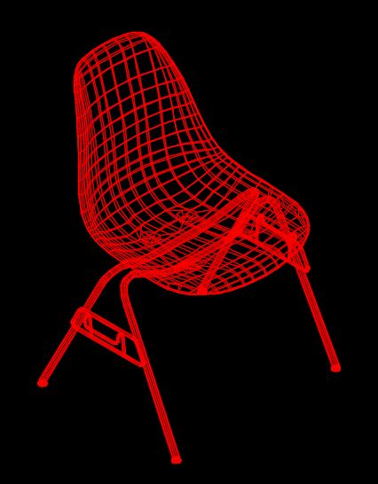

ReMark Posted January 21, 2017 Posted January 21, 2017 Next up is this red chair. It is comprised of 2298 3D faces. Put ten of these chairs in your drawing and you have 22,980 entities. The components that go into making up the chair are on two layers (Seat & Seat base) each with an assigned color (white & blue) but someone has decided to override and make red. I think all the objects comprised of 3D faces may have originated as 3d solids but were downloaded then exploded. Quote

ReMark Posted January 21, 2017 Posted January 21, 2017 (edited) How do I make it into a single solid object? Don't even attempt to do that if you don't want to lock up your system. When you downloaded the block it must have been to a folder on your hard drive. You could erase all the chairs and tables that are comprised of 3D faces then run the Insert command and reinsert each different block just don't explode them after you do. And put all chairs, tables and couches on a dedicated layer called Furniture. Put all kitchen equipment on a layer called Equipment. Edited January 21, 2017 by ReMark Quote
