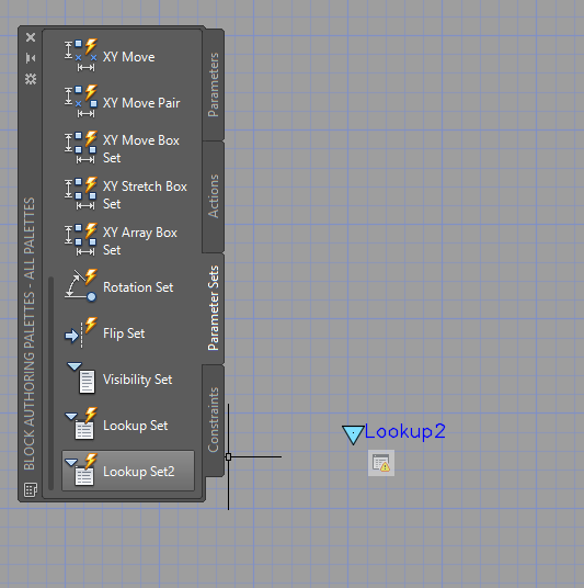

RyanAtHC Posted January 19, 2017 Posted January 19, 2017 I am having trouble accomplishing this in ACAD 2017. https://knowledge.autodesk.com/support/autocad/learn-explore/caas/CloudHelp/cloudhelp/2016/ENU/AutoCAD-Core/files/GUID-CCF67081-3278-42D6-8AB1-BFF4EB50FB6B-htm.html When I add the second lookup action to the new parameter set, it will only show one action when I use the new parameter set, despite the fact that it shows two actions in the properties menu of the new parameter set. I cannot add a second action to the parameter. It says that it is already associated with a lookup table. Any info would be very helpful. Thanks! Quote

RyanAtHC Posted January 19, 2017 Author Posted January 19, 2017 Correct, when I follow the steps in the link in my first post, the new parameter set only shows one action when two are listed in the properties. Quote
RyanAtHC Posted January 19, 2017 Author Posted January 19, 2017 Oops misread. I want to add the double parameter. I have already used the one to set up what I want. I want to be able to do it from scratch. Quote
RyanAtHC Posted January 19, 2017 Author Posted January 19, 2017 Part of me thinks an issue with 2017 because I've seen videos of it being done in earlier versions. When the same steps from the link were followed in the video, a parameter appeared with two actions, just like in the example file I sent. Quote

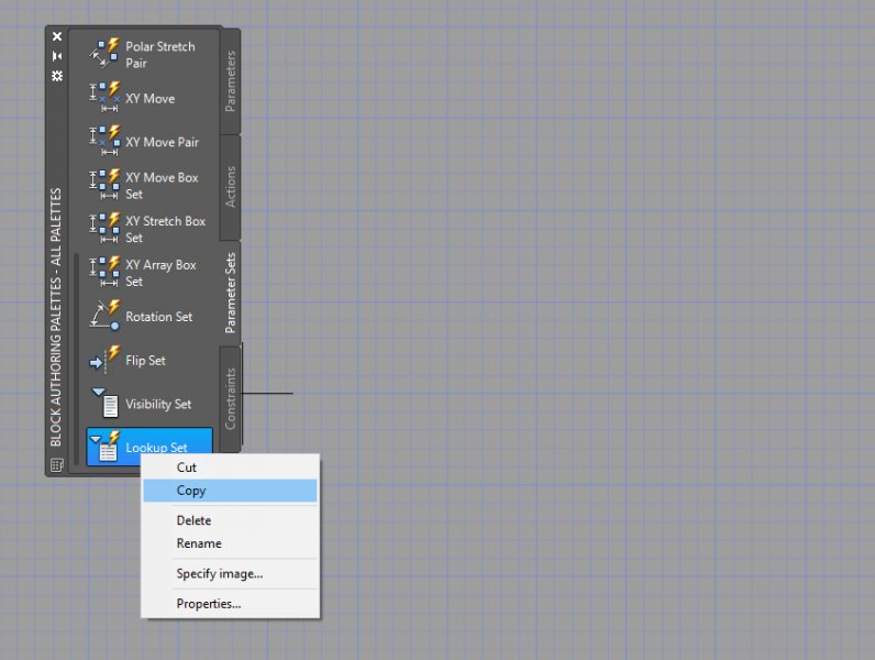

steven-g Posted January 19, 2017 Posted January 19, 2017 It does work, give me a minute to grab a few screen shots Quote

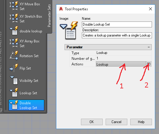

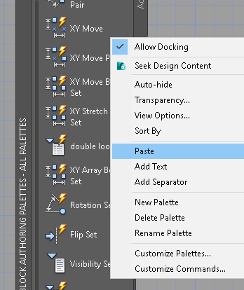

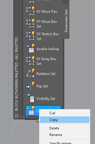

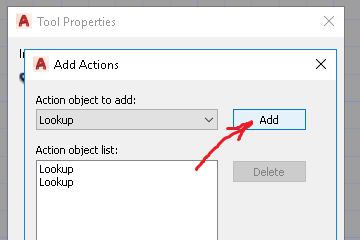

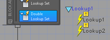

steven-g Posted January 19, 2017 Posted January 19, 2017 Right click the lookup parameter set and select copy Right click again somewhere between 2 of the sets (where nothing is highlighted) and paste, Right click on the new set and rename it “Double lookup set”, and then again right click on the new set and select properties Click into the actions box to highlight it and you see a new icon appear on the right (2) click on this (lots of clicking here) With some parameters you can select different ones in the “action object to add” drop down list but for lookups there is no choice available, so just click on the add button and another lookup will appear in the list, press ok twice to get out of the properties, and you should now have a working double lookup Good luck and have fun you can do some fantastic things with this combination. Quote

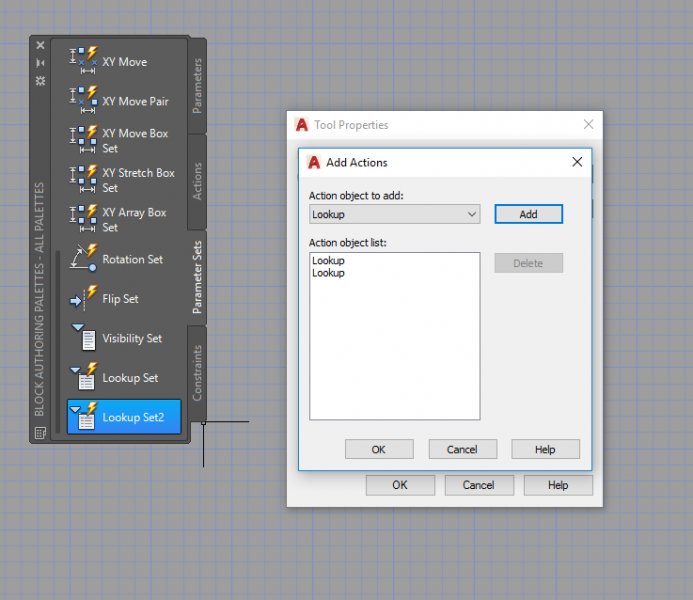

RyanAtHC Posted January 19, 2017 Author Posted January 19, 2017 Those are the exact steps I followed in AutoCAD 2017. My result is a lookup1 with only one action. I'll attach my screenshots. Quote
steven-g Posted January 19, 2017 Posted January 19, 2017 I just did this with 2017 LT no problems, just a thought check the variable bactionbarmode=0 otherwise you will get a different visual Edit You posted just before me yeah bactionbarmode is your problem 1 1 Quote
RyanAtHC Posted January 19, 2017 Author Posted January 19, 2017 And it looks like you are using a different version of Acad than me. I am leaning more and more to an Acad 2017 issue. Quote
RyanAtHC Posted January 19, 2017 Author Posted January 19, 2017 It is always some system variable lol Quote
