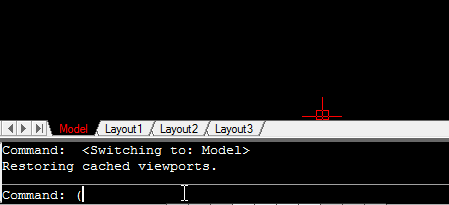

Tharwat Posted January 19, 2017 Share Posted January 19, 2017 The first tab of the function layoutlist would not reorder the tabs if for instance the first layout is relocated by the user. Quote Link to comment Share on other sites More sharing options...

tive29 Posted January 20, 2017 Author Share Posted January 20, 2017 The first tab of the function layoutlist would not reorder the tabs if for instance the first layout is relocated by the user. Base on the drawing setup, the 1st layout name will always be the one. Quote Link to comment Share on other sites More sharing options...
Tharwat Posted January 20, 2017 Share Posted January 20, 2017 Base on the drawing setup, the 1st layout name will always be the one. Have a look: Quote Link to comment Share on other sites More sharing options...
Grrr Posted January 20, 2017 Share Posted January 20, 2017 (edited) Ok, after Tharwat's remark you could use this: (defun SortedLayoutsList ( / L ) (vlax-map-collection (vla-get-Layouts (vla-get-ActiveDocument (vlax-get-acad-object))) (function (lambda (x) (setq L (cons (list (vla-get-TabOrder x) (vla-get-Name x)) L)))) ) (mapcar 'cadr (cdr (vl-sort L '(lambda (a b) (< (car a) (car b)))))) ); defun SortedLayoutsList (SortedLayoutsList) instead of (layoutlist) EDIT: Or just straight obtaining the first tab (for this specific task) : ; (GetFirstLayoutTab) (defun GetFirstLayoutTab ( / Lcoll ) (setq Lcoll (vla-get-Layouts (vla-get-ActiveDocument (vlax-get-acad-object))) ) (vl-some '(lambda (x) (if (= 1 (vla-get-TabOrder x)) (vla-get-Name x))) (mapcar '(lambda (x) (vla-item Lcoll x)) (layoutlist)) ) ) Edited January 20, 2017 by Grrr Quote Link to comment Share on other sites More sharing options...
