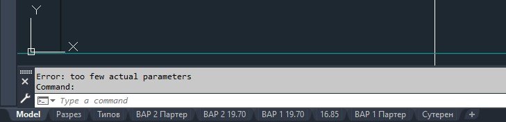

I tried the update of mhupp - Insert Block at Block insertion point, but at the end I have an error.
Error: too few actual parameters

Can someone give an advice how to fix the error with too few actual parameters?
