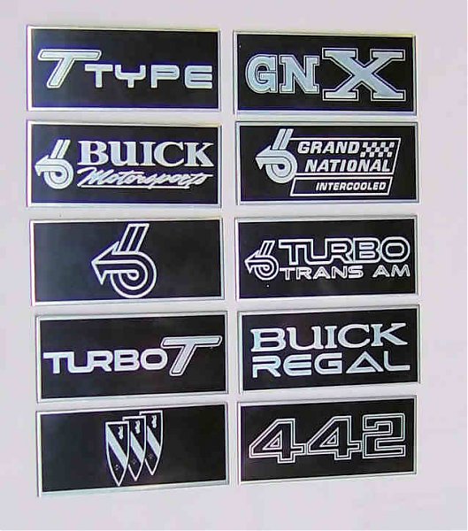

scot w. Posted January 12, 2009 Posted January 12, 2009 Well I think what i'm asking would be pretty simple to do but I can't seem to have any luck. I'm trying to take a Sticker / Emblem and convert it to a line drwaing of it in a DXF format. I was wondering if there is Anything out there that can take a Sticker or an emblem and have it scaned and produce a nice smooth line drawing. I'm having some stuff Laser Engraved and the engraver first said it wasn't a problem and now once he scaned a sticker and the lines don't look smooth magnafyied at 800% he said it won't work and that I need to have CAD drawings before he can continue. He recently gave me a REALLY OLD copy of KeyCAD (94) and told me to try and draw them and send him the DXF files. LOL I NEVER even looked at a CAD software in my life. In two days already I have drawn 4 drawings that have turned out just awsome! BUT there has to be an easyier way to take a flat drawing of something and create another from it. ( Is there?) Here is some examles of material with the paterns on with what I want to re-create in DXF line drawing Filled in with black. Scot W. Quote

rustysilo Posted January 12, 2009 Posted January 12, 2009 At this point I think we've come to the conclusion (at cadtutor anyway) that there really isn't a way to automate this process. Most of us would end up just scanning the image, importing it into cadd, and then tracing it for the best result (or digitizing as ReMark said). There are a handful of softwares that propose to convert a raster file to a vector file, but you would still have to do extensive cleanup after the conversion in most every case. Since yours are just black and white logos maybe they would work better, but not sure. You could always go download a trial of one and give it a whirl before spending the money. Quote
rustysilo Posted January 12, 2009 Posted January 12, 2009 Here is one such software that appears to allow you to do it online at a price as well as the option to buy the software. If I read it right you can try one for free. http://vectormagic.com/ NOTE: Doesn't look like it supports .dxf output. Quote
rustysilo Posted January 12, 2009 Posted January 12, 2009 Here's something to try. Download and install Inkscape if you don't have it already. Open it. Go to File > Import. Then Shift-Alt-B (or Path > Trace Bitmap) for the "trace bitmap" function (might toy with the settings). Click OK. Saveas .dxf and see how that works. I am unable to open the file in AutoCAD 2008, but maybe his software or your KeyCAD will. It appears to do a good job on the image you posted though and I'm sure that your actual scanned images are even better to work with. Quote

rustysilo Posted January 15, 2009 Posted January 15, 2009 Here's an addendum to my previous post about using Inkscape that you might give a try. http://www.sinogowitz.ch/pdf/dxf_freeware_tutorial.pdf Quote
rustysilo Posted January 15, 2009 Posted January 15, 2009 I just gave it a shot and it came out sorta OK. I imported the dxf into cademia. I first generated only centerlines with pstoedit and that didn't work worth a hoot in a hollar. Then I generated outlines and it produced better results. It might work with some testing and troubleshooting with different settings. I'm gonna have to try it with AutoCAD at work when I get a chance. Quote
