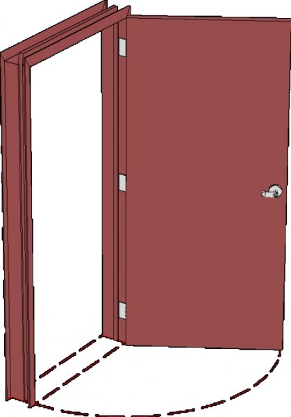

David Bethel Posted January 22, 2017 Share Posted January 22, 2017 I like the door jambs David, it was the next thing to do to "Cadarc" its like your program started life 1990's Thanks ! I looked at my current 3D door program for starters. Even as my newest, it was started 2008. Quote Link to comment Share on other sites More sharing options...
David Bethel Posted January 22, 2017 Share Posted January 22, 2017 (edited) Not to hijack a thread, but I needed to update my door routine any way 1.2 Added door knobs This is pretty much the format I use for complete routine Maybe it could help. -David DOOR3D.LSP NEWDHAND.DWG NEWDKNOB.DWG NEWDPULL.DWG Edited January 23, 2017 by David Bethel Added a few options Quote Link to comment Share on other sites More sharing options...
tzframpton Posted January 22, 2017 Share Posted January 22, 2017 Thanks ! I looked at my current 3D door program for starters. Even as my newest, it was started 2008.This is very Revit-ish. Good door David. -TZ Quote Link to comment Share on other sites More sharing options...
BIGAL Posted January 23, 2017 Share Posted January 23, 2017 Nice one David. Its amazing what you can do with 2.5D combined with a bit of full 3D. Quote Link to comment Share on other sites More sharing options...
David Bethel Posted January 23, 2017 Share Posted January 23, 2017 Thanks guys ! The Revit-ish probably comes from the fact I used a R13 SHADE and then SAVEIMG. From what I've seen of Revit, the screen can look like this 2.5D LOL. It's kind of amazing the changes in the definition of the term extrusion in CAD has changed over the years -David I updated post #22 with few fixes and options Quote Link to comment Share on other sites More sharing options...
tzframpton Posted January 23, 2017 Share Posted January 23, 2017 The Revit-ish probably comes from the fact I used a R13 SHADE and then SAVEIMG. From what I've seen of Revit, the screen can look like thisI was referring to the parametric program as well as the look of the door. -TZ Quote Link to comment Share on other sites More sharing options...
David Bethel Posted January 23, 2017 Share Posted January 23, 2017 I was referring to the parametric program as well as the look of the door. -TZ OH I don't think that I have seen a Revit parametric. This could be done in DCL, but what a lot of work ! NOT today, or anytime soon Quote Link to comment Share on other sites More sharing options...
tzframpton Posted January 23, 2017 Share Posted January 23, 2017 OH I don't think that I have seen a Revit parametric. Everything in Revit is parametric. All of the examples of your kitchen equipment remind me of Revit. You've been using AutoCAD like Revit for a long time, actually. *EDIT* Sorry to derail. Please continue normal topic. -TZ Quote Link to comment Share on other sites More sharing options...
