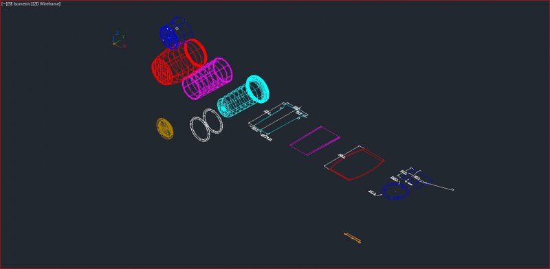

Robert Newton Posted January 6, 2017 Share Posted January 6, 2017 Morning guys, I am new here and have a problem some of you may have encountered. When I click enter or save the drawing gets little tiny and jumps up in the upper left corner. It does it over and over Quote Link to comment Share on other sites More sharing options...

Robert Newton Posted January 6, 2017 Author Share Posted January 6, 2017 It is hard to see but it should be in the upper left corner (little tiny just below the coordinates symbol) Just start panning and it should come into view. Sure hope u can get me fixed and thanks for your help 1st Attempt 3D Model.2dwg.dwg Quote Link to comment Share on other sites More sharing options...

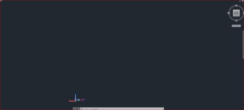

Robert Newton Posted January 6, 2017 Author Share Posted January 6, 2017 ReMark it is doing it again but now when I click enter or save the drawing it getting tiny and going to the bottom of the screen. Limits are still set at Zero. Quote Link to comment Share on other sites More sharing options...

Cad64 Posted January 7, 2017 Share Posted January 7, 2017 I don't know why this is happening with your drawing file, but if you switch to Wireframe before saving it stops this from happening. From some reason Realistic and Shaded visual styles are causing the drawing to jump around when saving. Since I don't know why this is happening, I don't know how to stop it from happening. As a workaround, you could use a custom lisp routine like the one below that will switch to wireframe visual style, save, and then switch back to shaded visual style. Just load it and type SS at the command line to run it. (defun c:ss ()(command "vscurrent" "2") (command "qsave") (command "vscurrent" "s") (princ) ) By the way, all 3 of your posts are there. You may need to refresh your browser to see them. Quote Link to comment Share on other sites More sharing options...
Dadgad Posted January 7, 2017 Share Posted January 7, 2017 I am really confused--- I have replied twice (this being the 3rd time) and still don't see he posts anywhere --- guess they are still in cyberspace. Being new to the forum, your posts are subject to Moderation, which is why they might not immediately show on the forum. Based on Cad64's observations, I tried to ZOOM Extents, as well as ZOOM All, in the Shaded visual style, and had similar results to yours. I then changed the visual style to 2D Wireframe, which is the one I typically use when modeling, after which both of the ZOOM options produced satisfactory (meaning, as expected) results. Sounds like Cad has got you sorted out now though, or you can just switch to 2DWireframe visual style. Quote Link to comment Share on other sites More sharing options...

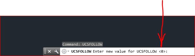

Cad64 Posted January 8, 2017 Share Posted January 8, 2017 Ok, after playing around with your file a bit more, I found the problem. Type UCSFOLLOW at the command prompt and change the value to 0. Quote Link to comment Share on other sites More sharing options...
Robert Newton Posted January 8, 2017 Author Share Posted January 8, 2017 It was already at 0 but I changed it to 0 just to make sure. The drawing still gets little tiny toward the bottom when I do zoom extents. Thanks Cad. Quote Link to comment Share on other sites More sharing options...
