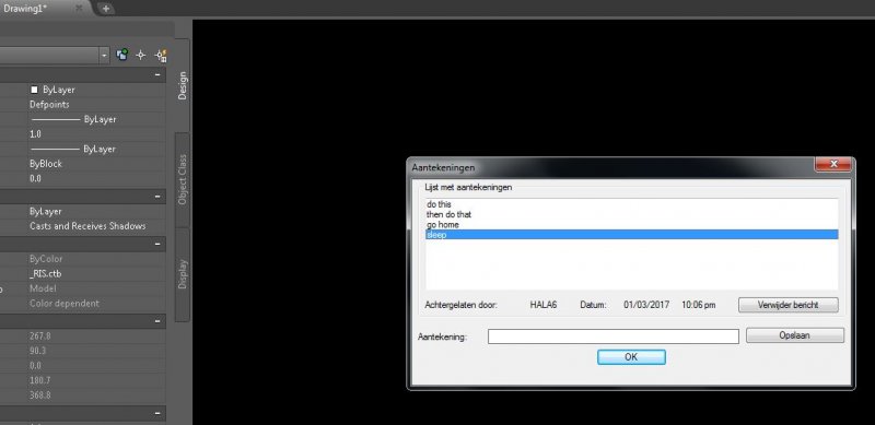

I sometimes use this old routine to make sort of sticky notes inside DWG format.
Its nice that if you save a note it will be prompted once you open the DWG,
Logical, it only works if you start up with lsp

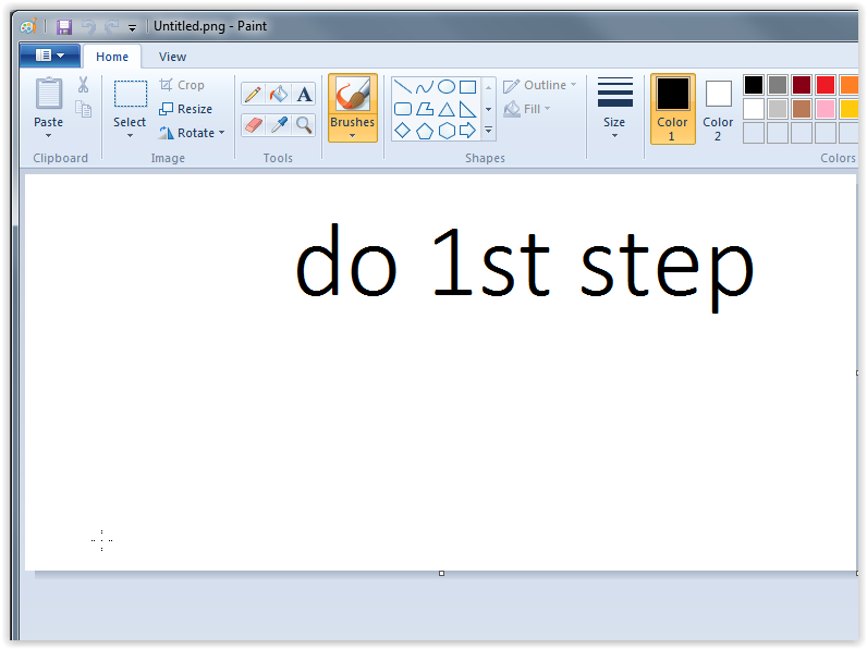

Similar to Halam's suggestion (setvar "modemacro" "Do 1st step import points") in acaddoc.lsp and like others just keep changing the modemacro as you complete the steps, just have the (setvar "modemacro" "Attach block now") as last line in your 1st lisp and so on.
Make a image etc and save it, like this code (STARTAPP "mspaint" "C:\\acadtemp\\untitled.png") pops up in front of my Autocad annoying me to do something.

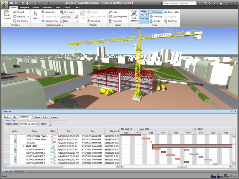

Haha god damn it i think you found it by accident. Not sure though if it realy is this one, but when i google one note for autodesk and i saw naviswork as the product company, i then googled naviswork and there is this software called manage. I'm not sure though if it was a previous releas and they dropped it and now do one note for autocad, since these one is focused primarily on construction management and architecture and stuff, but the environment as you can see looks kinda fmailiar to what i remember once seeing. Take a look at the bottom, plus the gannt charts. I'll have to investigate a little further, but finally this is a steer to the right direction.
Navisworks Manage was originally "Jetstream" before Autodesk bought it. The Timeliner you're seeing is Navisworks' ability to connect to Microsoft Project construction schedules for simulation. Navisworks is not an authoring software, only a viewer/model manager software. This probably isn't the program you used previously since Navisworks is its own software that does not integrate into AutoCAD other than export functions.
-TZ
I dont recall a product by the jetstream name. Naviswork was they word thar ringed a bell and moved me into searching its products. So if not navisworks, then something with the look and feel of that timeliner. So you say the timeliner is an option that connects to onenote? Does that mena with onenote installed i can get timeliner on autocad?
Because essentailly thats what i need. As you can see, you have the task name, the completion status, the planning dates and a gannt chart. Thats what i was asking all along
