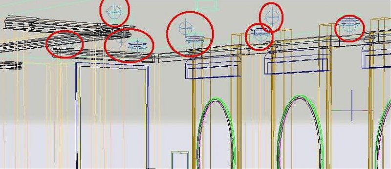

these last two days ive been working on a rendering of enterior of a salon that my boss ask me to do... im using 07....
then when im adding lights... its very confusing coz when ever something there is revisions in the model, the light icons i cannot hide it... so its very annoying..... is there a way to hide the light icon in 2007?
and in 05 and lower version.... to hide the light icon... is to turn of layer of light ashade.. thats simple but in 07 i cant figure it out how to do it....

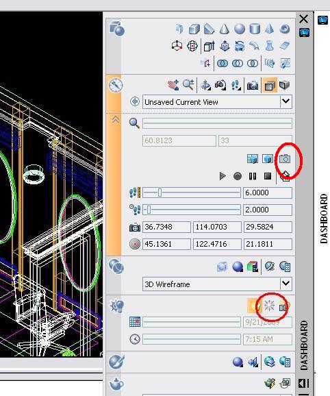

Yes there is a sysvar to hide the light glyphs, look
Under the view menu.
sir,
thanks a lot... got it now....:D
I believe you can even put the lights on a layer and freeze the layer as well.
