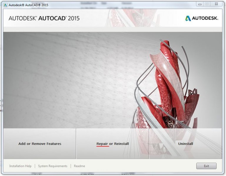

setareh26 Posted December 27, 2016 Share Posted December 27, 2016 HI ! my autocad program always is ok ! but today it has an unusual eror with opening a special file . the point is here that the file can be opened in the other computers !! only in mine it has the opening problem ... the problem is that when I open it , autocad crash and be not responding ... I had done something like : 1- use the recover and recoverall commends . 2- someone use the purge and audit commends and send the file to me. 3- someone saved in .dxf format but the problem didn't solve !! please help me ! Quote Link to comment Share on other sites More sharing options...

ReMark Posted December 28, 2016 Share Posted December 28, 2016 The REPAIR option can be found by clicking on Start > Control Panel > Programs & Features > AutoDesk AutoCAD 2015. Once you click on that last one look at the top of the window for Uninstall/Change. Click on Uninstall/Change. The next window you see should look like this. Click on the Repair/Reinstall button. You should be able to handle it from here. A REPAIR of an installation will fix any missing and/or corrupted program files. I don't see any call for attaching your drawing here at this time. Let's see if the REPAIR option takes care of the problem. Are you up-to-date as far as service packs go? Quote Link to comment Share on other sites More sharing options...
setareh26 Posted December 29, 2016 Author Share Posted December 29, 2016 Thank you for your guidance...... with this methodوThe problem is solved. Thanks again................. Quote Link to comment Share on other sites More sharing options...
