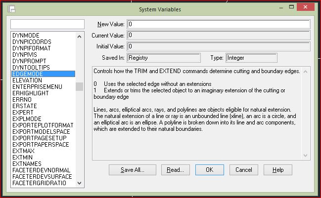

Dadgad Posted December 27, 2016 Posted December 27, 2016 Welcome to CADTutor Merve. That is just how the TRIM command works, it is not a problem due to a system variable setting. Have you tried using the TRIM ALL option, that is the one I usually use, but yes, you will need to select the items sequentially. The system variable which does affect the TRIM command is shown in the screenshot, but it won't help you with your perceived problem. Be sure to follow the commandline prompts closely, is usually a good rule of thumb. Quote

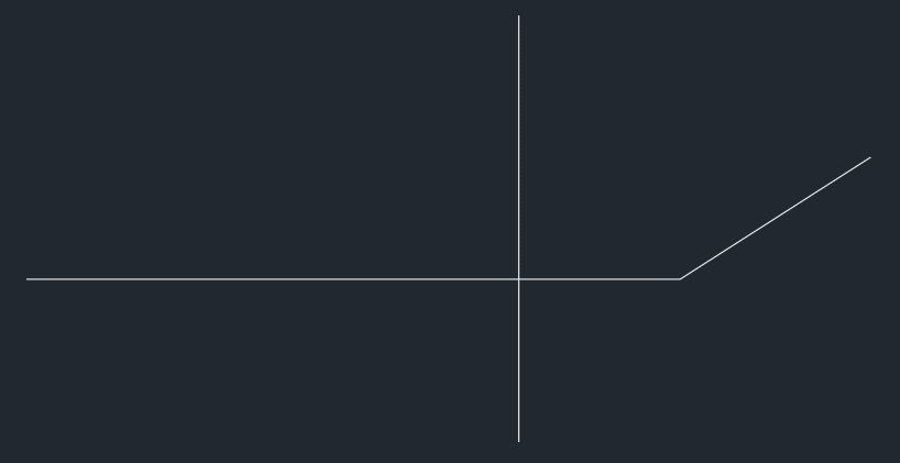

Ncik Posted August 8, 2019 Posted August 8, 2019 (edited) G'day everyone, New here but a similar problem. After 15+ years of AutoCAD use, trim has started behaving oddly. Please see the attached gif. Normal selection will not trim a very simple polyline, but window selection will. Note the little icons near the cursor. Sometimes the window selection will not work properly either. AutoCAD 2018 Any thoughts? Edited August 8, 2019 by Ncik Quote

CyberAngel Posted August 9, 2019 Posted August 9, 2019 Is it possible that the polylines are at different elevations? Is it possible that they are on different layers, and one is locked? Have you used Repair? Quote
Cad64 Posted August 11, 2019 Posted August 11, 2019 On 8/9/2019 at 10:25 AM, SLW210 said: I'm not having that problem here on AutoCAD 2018. Expand Same here. Works fine in 2018. I think we need more information or maybe a sample drawing to test, although I can't think of any variables or circumstances that would cause this issue. When you click on the line to trim and it fails, do you get any message at the command line about why it can't trim the line? Quote
SLW210 Posted August 12, 2019 Posted August 12, 2019 My WAG would be video card or driver. Took me a few tries to find a driver for 2018 on Windows 7 that didn't have quirks like that. A little more information on your Computer, OS, Graphics, etc. Maybe a drawing that does this, just to eliminate things. Quote

eirCAD Posted May 6, 2020 Posted May 6, 2020 @Ncik I see this happen when the polyline is in several parallel segments, possibly layered back over itself. Can't tell if it's the case here as no grips visible but might be. Quote
