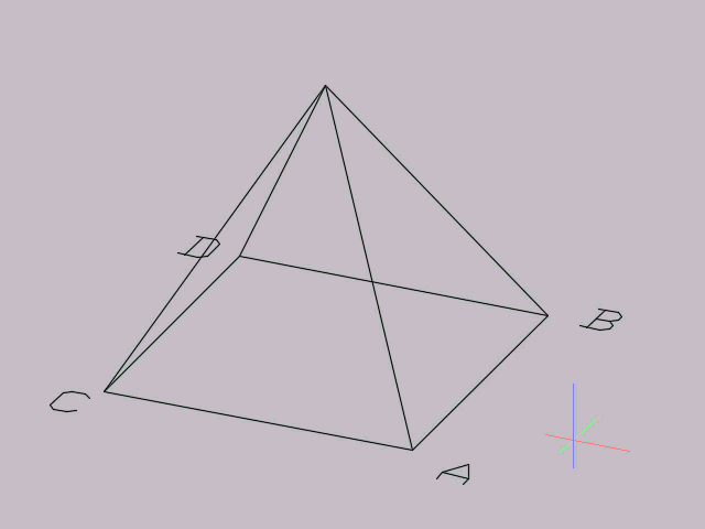

khoshravan Posted December 24, 2016 Posted December 24, 2016 In the attached drawing, I want the angle between planes ABEH and ACDB to be 90 degrees. How should I define the pyramid to obtain that shape? piramid.dwgFetching info... Quote

khoshravan Posted December 25, 2016 Author Posted December 25, 2016 paulmcz said: Can't find plane ABEH or points E and H. Where are they? Sorry I uploaded a wrong drawing. In this drawing I want plane OAB to be perpendecular to ABCD plane. Quote

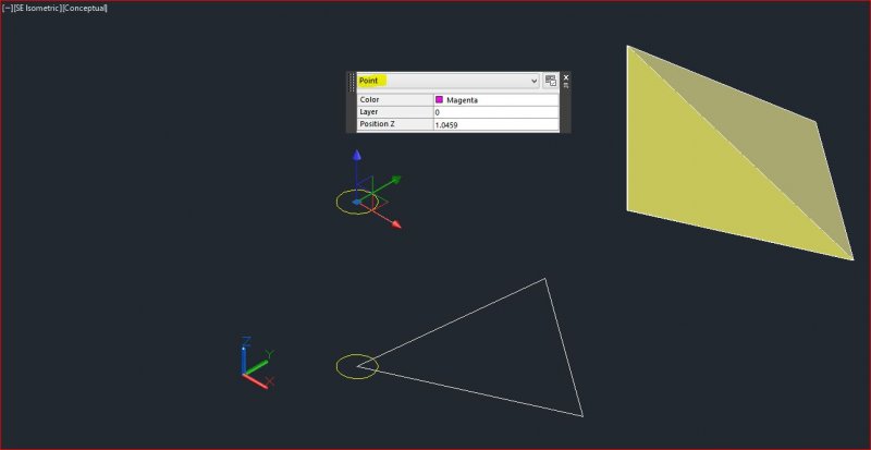

Dadgad Posted December 26, 2016 Posted December 26, 2016 (edited) khoshravan said: Dear DadgadYou are correct. I want a right pyramid. Although your notes are helpful but couldn't get a hint from your notes on how to do it? I am new to 3D and don't know how to do it. The only new command I saw in your reply is loft and I will give it a try. Create the base of your pyramid. At whichever vertex you want to be the right angle along the Z axis, create a point. Switch to an Isometric perspective, select the Point and move it up orthogonally along the Z axis, to the appropriate distance, representing the height of your pyramid. Start the LOFT command, select the POint option from the commandline prompts, then just follow the prompts, very simple. If you look at my screenshot, you can see the point which is highlighted with a circle, and now selected, above the left most vertex of the triangle on the left side of the screenshot. Loft to a Point is pretty darned straight ahead, as long as you are in an isometric perspective, so you can see what is going on. Edited December 27, 2016 by Dadgad Quote

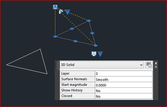

GP_ Posted December 27, 2016 Posted December 27, 2016 (edited) khoshravan said: How should I define the pyramid to obtain that shape? From your dwg: Edited December 27, 2016 by GP_ Quote

BIGAL Posted December 28, 2016 Posted December 28, 2016 Using Gp method No ucs etc create POINT mid point of base line use properties change Z of point, Ctrl pick top pyramid pick Node all done then erase node. Autocad always has so many ways to do one task. Also thought about 3dfaces convert to surface convert to solid. Not sure how to pick top of pyramid point if it was to be automated.. Quote
