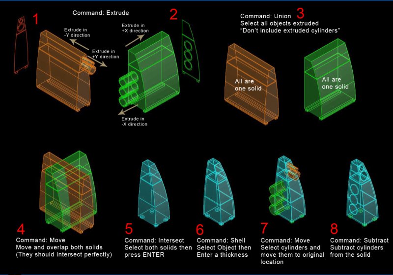

cmo_uk Posted December 23, 2016 Posted December 23, 2016 Hi, I'm quite new to 3d objects but fairly familiar with 2d. I have an object with 2 side elevations and 1 plan elevation and I would like to turn it into 3d, however due to the various curves on front and side I am stuggling a little as to what tools to use as I've played around with the extrude command which is fine for one side elevation and plan view but I need to also incorporate the front elevation which has its own curves. I have attached the elevations and plan as an image, so if anyone can give me some suggestions on how to achieve this it would be greatly appreciated. Kind regards, Chris Speaker.pdf Quote

ADSK2007 Posted December 30, 2016 Posted December 30, 2016 You don't really need the Top View - All you need is both side and front view 1- Place each view to a correct UCS then use the "Extrude" Command 2- (Extrude speaker body in - direction and speakers cylinders in + direction) 3- Use Command "Union" and select the Speaker Body & Blocks under the body (Do not select the speaker cylinders) 4- Move one solid over the other and make sure they perfectly intersect 5- Use Command "Intersect" then select both solids (at this point you should have your model) If you wish to go further then use commands below 6- Use Command "_solidedit" "Shell" and give it a thickness 7- Use Command "Move" and place the Speaker cylinders over the shell model (you can use your snap F8 and select "end point" to be precise 8- Subtract cylinders from your final model Done Quote
