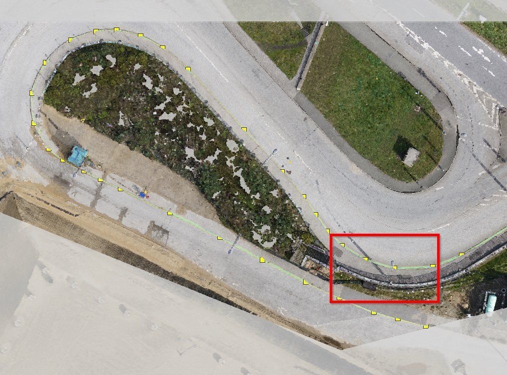

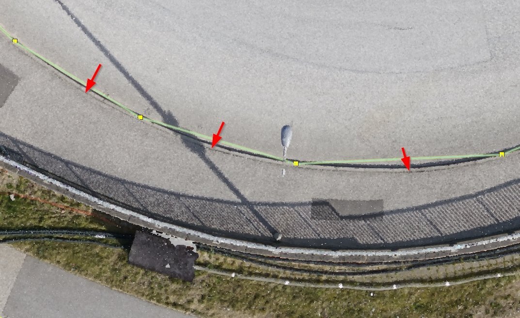

Vittorio Posted June 12 Share Posted June 12 Sorry for reviving this old thread, but it seems to be exactly what I've been looking for. I have a Civil 3D drawing with a RCP Point Cloud and an Orthofoto and 3D Polylines (exported from Leica Cyclone 3DR). The problem is that those Polylines don't match with the reality, only its vertices. What I need to do is drawing Splines and 3D-Polylines on top of the existing (from 3DR) 3D-Polyline Vertices, depending if the segment is curved (> Spline) or linear (> 3DP) to match the real world edges. Since the Polylines have a large number of vertices this procedure is time-consuming. Now I've found this interesting and promising thread and I wonder if any of those LISP routines posted here will get this task done. The above is just for explanation. Actually what i need to do is drawing a Spline by connecting all Vertices of a selected 3D-Polyline. Here are two screenshots showing the scenario: Could someone please tell me if one of the posted LISP functions will work for me? Many thanks in advance. Quote Link to comment Share on other sites More sharing options...
marko_ribar Posted June 12 Share Posted June 12 1 hour ago, Vittorio said: Sorry for reviving this old thread, but it seems to be exactly what I've been looking for. I have a Civil 3D drawing with a RCP Point Cloud and an Orthofoto and 3D Polylines (exported from Leica Cyclone 3DR). The problem is that those Polylines don't match with the reality, only its vertices. What I need to do is drawing Splines and 3D-Polylines on top of the existing (from 3DR) 3D-Polyline Vertices, depending if the segment is curved (> Spline) or linear (> 3DP) to match the real world edges. Since the Polylines have a large number of vertices this procedure is time-consuming. Now I've found this interesting and promising thread and I wonder if any of those LISP routines posted here will get this task done. The above is just for explanation. Actually what i need to do is drawing a Spline by connecting all Vertices of a selected 3D-Polyline. Here are two screenshots showing the scenario: Could someone please tell me if one of the posted LISP functions will work for me? Many thanks in advance. Here, you meight find these 2 routines useful... Here is the link : https://www.theswamp.org/index.php?topic=59534.msg620732#msg620732 Regards, M.R. Quote Link to comment Share on other sites More sharing options...
BIGAL Posted June 12 Share Posted June 12 Just a personal comment. Having worked on road designs for to many years I am not sure you will get a correct answer that you may be looking for. In the image it looks like a kerb edge so using cloud data is based on a grid pattern, so you can have a interpreted point that is a top of kerb and next point is lower at lip of kerb. The big issue with using clouds is they suffer when it comes to vertical edges. If a drone is used its scanning vertically on a grid basis, if a 3d scanner is used you may get a more realistic model as it can detect the change in edge levels. Think Gb clouds. Think of the Google car views as you walk down the road. Marko has given you an answer to the CAD question but for me as a designer I would have that portion field surveyed if your gong to use it for design purposes, a man with a stick. We surveyed one point on kerb and back in office added 2 more with offset and Z change. Our confidence on z level was like less than 10mm. Lastly we did compare a instrument survey with a drone cloud and found a +- 20mm max difference of points on a flattish length of road. Showing that under certain design criteria clouds were very useful. Quote Link to comment Share on other sites More sharing options...
