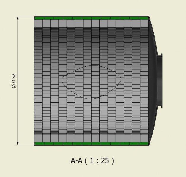

I want to break out the two layers of lining in this kiln. Only to leave steel. But If I choose steel to not participate in section all steel show immediately since this view actually is also a section. How do I solve that, I must section in order to see inside.

Lining is one part, multibody two solids Steel is one single part. All is round

I tried different representations with no luck, If I make a hole in my lining I need to choose on drawing If I want with or without that hole. But I did not suceed to Control "supressed feature" with this? Maybe some other obvious way :-)
