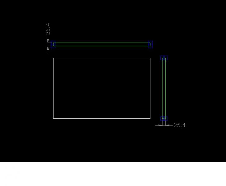

Lastly, can the lisp routine be modified so as to allow the user to enter the thickness of the panel? It currently has a default value of 25.4 which i've applied to a button and is applicable for most of my work flow. But in the odd cases I need a different value, a second button which allows for user defined input would help as well.
Yup:

I like your use of the 'right' & 'top' functions - I see that you have a good understanding of mapcar now :thumbsup:
However, note that the *error* function requires a single-argument - the following will return a 'too many arguments' error if an error is encountered:
(defun *error* nil (redraw) (princ))
