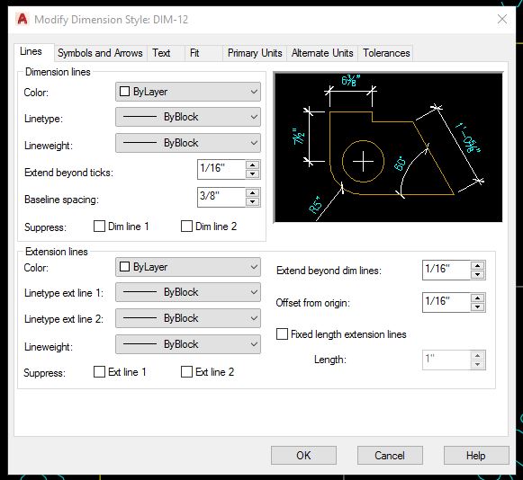

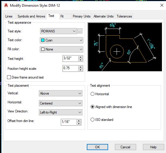

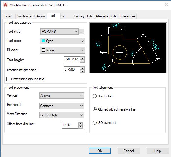

jaff Posted December 15, 2016 Posted December 15, 2016 Does any one knows how to suppress zeros in dimension dialog boxes? For example, for the dimension style (Se_DIM-12) the text height reads 0'-0 3/32" and I want it to read 3/32" (eliminate all the zeros) as in dimension style (DIM-12). See attached screen shots. Quote

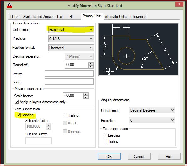

Dadgad Posted December 16, 2016 Posted December 16, 2016 (edited) On the Primary Units tab, set your Units format as Fractional, and select Leading Zero suppression, as shown in the screenshot... You may want to also apply Leading zero suppression in your angular dimensions. Edited December 16, 2016 by Dadgad Quote

SLW210 Posted December 16, 2016 Posted December 16, 2016 RobDraw, Dadgad, I think you both have completely missed the question. The OP wants to suppress the zeros in the dialog box, not in the dimensions. Mine stay if I type in just 3/32", 1/8", etc. (or even .09375 or .125), though they default to leading zeros and will return if I just delete the zeros from what is the default. Not sure what drives the zero displays in the dialog boxes. Quote
Dadgad Posted December 16, 2016 Posted December 16, 2016 RobDraw, Dadgad, I think you both have completely missed the question. The OP wants to suppress the zeros in the dialog box, not in the dimensions. Mine stay if I type in just 3/32", 1/8", etc. (or even .09375 or .125), though they default to leading zeros and will return if I just delete the zeros from what is the default. Not sure what drives the zero displays in the dialog boxes. SLW, yeah, having reread the thread, I believe you are correct. Rob in his screenshots, the dimension on the right side diagonal edge is displaying the unwanted leading zero. Now that I think I misread the problem, this doesn't really seem like a big problem, since as the OP says his actual dimensions are fine. I mistakenly thought THEIR display was the problem. Quote
jaff Posted December 16, 2016 Author Posted December 16, 2016 SLW... Thank you for clarifying my post to RobDraw & Dadgad. RobDraw: I am posting the files. The Se_DIM-12 shows the leading zero feet and zero inches in the DIMSTYLE DIALOG BOX. The DIM-12 shows no leading or trailing zeros in the parameters. (see screen shot) I am just curious of why and how this happens? It is not a serious matter. Thank you all for the help. It is truly appreciated. p.s.: WHAT IS "OP" STANDS FOR? Se_DIM-12.dwg DIM-12.dwg Quote
