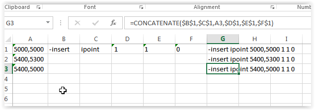

Look at using excel to create the script using the concatenate command copy the column to notepad and save as a script.
Your horizontal format works! Thanks! The script doesn't stop after the third line is executed. I have to press ESC, or simply wait for the prompt for a rotation angle to disappear. When you save the script in Notepad, you must leave the last line empty. The cursor must be at the beginning of the fourth line, in my case. If not, the script won't execute properly. When I saved the script with the cursor at the end of the third line, only the first line of the script executed.
