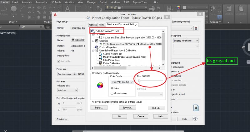

I want to know how to Increase DPI for jpeg when we plot. by default its only 100dpi which is quite low.
Rather set up a custom paper size with say 600DPI (ie 46" x 600 pixel width for an A0) and plot to fit. That should give you a 600DPI image.
thanx spaj that solved my problem.

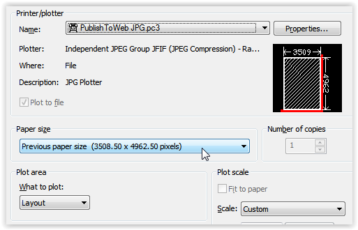

Like spaj you can work out your pixel sheet size as a custom sheet size pretty easy. We plot our A1 36x24 at 200 dpi, A4 letter at 400 dpi
Just take the plottable area and work on dpi required 36" @ 200 = 7200
Metric need 841/25.4*200 = 6622
