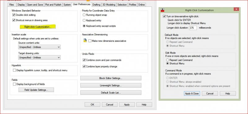

Dj_T_Rex2002 Posted December 29, 2016 Author Posted December 29, 2016 If you are unfamiliar with it, you might want to check out time-sensitive right-click.It enables you to combine the ENTER command, and or, access the Shortcut menu easily on the fly. I did what you showed in the pic but it only drags the object rather than displaying the menu Quote
tombu Posted December 29, 2016 Posted December 29, 2016 I did what you showed in the pic but it only drags the object rather than displaying the menu Quick click for Enter and slightly longer click for the menu. You can set the delay in milliseconds. Don't drag the mouse! They added it as a feature to move objects, but not many care for it. Quote
tombu Posted December 29, 2016 Posted December 29, 2016 If you are unfamiliar with it, you might want to check out time-sensitive right-click.It enables you to combine the ENTER command, and or, access the Shortcut menu easily on the fly. 2nd that! I've had it on since it was introduced. Quote
Dj_T_Rex2002 Posted December 30, 2016 Author Posted December 30, 2016 Ok what I am trying to do is bring the object selected right click option. If you set the "Right-Click Customization" to Shortcut Menu on all, then select a wall and right click it bring an option to be able to modify that wall. That's why I said that it drags cause I select the object and then hold right click and does nothing. I want to bring that object's menu ... wish I could insert a picture but every time I hit the "upload file" it doesn't do it Quote
tombu Posted December 30, 2016 Posted December 30, 2016 Ok what I am trying to do is bring the object selected right click option. If you set the "Right-Click Customization" to Shortcut Menu on all, then select a wall and right click it bring an option to be able to modify that wall. That's why I said that it drags cause I select the object and then hold right click and does nothing. I want to bring that object's menu ... wish I could insert a picture but every time I hit the "upload file" it doesn't do it As long as "Shortcut menus in drawing area" and "Turn on time-sensitive right-click" are checked they should function fine. You can add Shortcut Menus, but they are for an AutoCAD object like Line, Arc, or LWPline. There are also Shortcut Menus for multiples of the same object as well since many options for multiple objects are different than you have for a single one. Is the "wall" you mentioned a line, polyline or some other object? Quote
