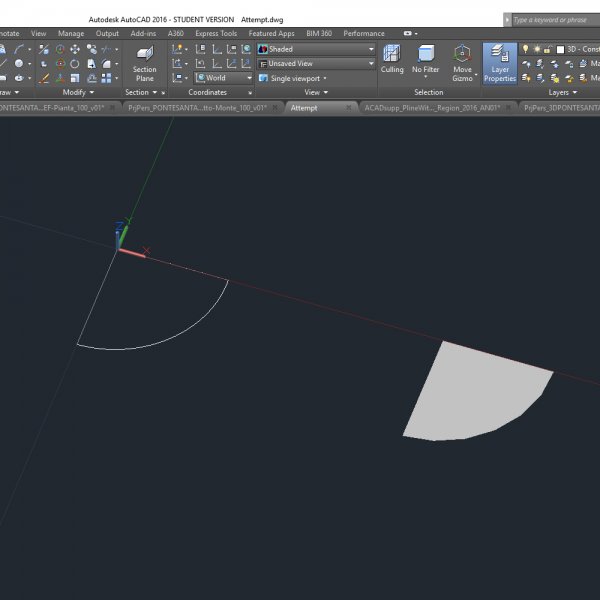

S'N'Shall Posted December 5, 2016 Posted December 5, 2016 Hi to everyone! First of all thnx for your attention. I'm a dummy in autocad so please forgive me if my question is not so clever . I've got a problem. I need to draw an architectural moulding of a historical bridge. So it'll be a moulding which runs all along the marble railing of the brige. That's why I've chosen to draw a section of the bead to make run all around. It's a closed polyline made of two segments and an arc, to be changed in a region to extrude along a path. But when it becomes a region, the arc loses its smoothness. I know it could be a display matter. I acted to get a soultion with command like Facetres, Viewres, Options and Display Res., moving res on 2D Wireframe but if I printed it, the region shows to be not smoothed in the curved part. As you can see I post a file to make it clear. Thnx in advance for your help! Have a good day! S'N'Shall Quote

ReMark Posted December 14, 2016 Posted December 14, 2016 I can't get it to be any smoother than it already is. I tried FACETRES which is the recommended procedure which is basically the same as Options > Display > Display resolution > Rendered object smoothness. BTW...VIEWRES is not the answer either. What does it look like when printed? Quote

S'N'Shall Posted December 14, 2016 Author Posted December 14, 2016 I can't get it to be any smoother than it already is. I tried FACETRES which is the recommended procedure which is basically the same as Options > Display > Display resolution > Rendered object smoothness. BTW...VIEWRES is not the answer either. What does it look like when printed? The same way it shows in the model. Not smotthed as in the model unfortunately. Attempt-Layout1.pdf Attempt-Layout2.pdf Quote
ReMark Posted December 14, 2016 Posted December 14, 2016 OK....you can stop now. The problem is that your geometry is so small AutoCAD cannot proper display a smooth curve. Do this little experiment. Scale the object 100 times then view it in the same manner as you did when it was much smaller. You should notice that the curve is much smoother. Quote
S'N'Shall Posted December 14, 2016 Author Posted December 14, 2016 OK....you can stop now. The problem is that your geometry is so small AutoCAD cannot proper display a smooth curve. Do this little experiment. Scale the object 100 times then view it in the same manner as you did when it was much smaller. You should notice that the curve is much smoother. But they're only 8cms side. Is it already too small to create this kind of scale problem? Quote
