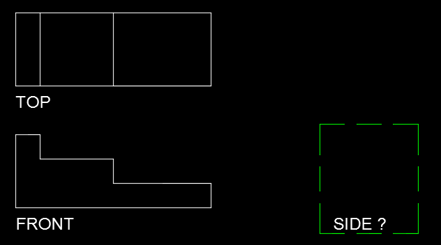

My question is not related to CAD directly, however some of you may help to get a proper answer. It is about drawing 3 views of an object.
My daughter is a 1st semester student in Mechanical Engineering dept. She has drawing course. She asks me to help her with following problem.
Two views from three views (top-front- side) of an object is given. She has to draw the 3rd view without knowing the perspective of the object.
She knows the basics but mess up when the question becomes hard.
What is your comments for helping her to master imagination techniques? Is there any downloadable book in this regard?
I have heard about a software which helps with mastering this techniques but a search in Google was not helpful.

I'm not sure how perspective enters into this problem since I think we are talking strictly about orthographic views. Perhaps your daughter should start out with a simple problem such as this one.
Given the top and front views draw the side view of the object pictured below. Hint: It's a matter of projection.

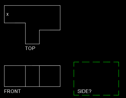

Here is another simple one with a slight difference. Note the end with the small "x". It must be accounted for in the side view. Hint: different linetype.

Google "Orthographic Projection". It's the way it was done back in the paper only days, and the easiest way to learn. You can make the top view to side view projection easier by simply copying the top view, place it directly over the place where the side view will be. and rotate it 90 degrees. Then project the lines down from it, and across from the front view.
Lines that appear on any other view and not on the aux view(s) should be hidden (dashed) lines.
