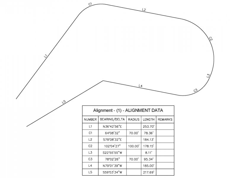

sandiegophil Posted November 30, 2016 Posted November 30, 2016 Hello, I am trying to find a simple way to number alignment segments sequentially and numerically. an example would be changing L1, C1, L2, C2 to 1,2,3,4. I also need this information to be applied to a table and be dynamic. Any and all help is appreciated. Regards, Phil Quote
BIGAL Posted December 1, 2016 Posted December 1, 2016 Not sure what you mean please post a dwg or a image. Quote
sandiegophil Posted December 1, 2016 Author Posted December 1, 2016 please see image above. when I add table tags it tags the alignment segments in the order they occur. Tangents are labeled L1, L2, L3... Curves are labeled C1, C2, C3... what I want to do is label the alignment segments 1, 2, 3, 4... regardless of if it is a tangent or curve, in order, from beginning to end thanks, phil Quote
BIGAL Posted December 2, 2016 Posted December 2, 2016 lee-mac has a nice polyline table generation which is almost identical to what you want. http://www.lee-mac.com/polyinfo.html Quote
MillerMG Posted December 2, 2016 Posted December 2, 2016 lee-mac has a nice polyline table generation which is almost identical to what you want. http://www.lee-mac.com/polyinfo.html Nice BIGAL!! I think that is dang near exactly what he is looking for!! Quote
sandiegophil Posted December 2, 2016 Author Posted December 2, 2016 BIGAL, That is going to work perfectly for my purposes. Your time is greatly appreciated! :notworthy: Thanks, Phil Quote
