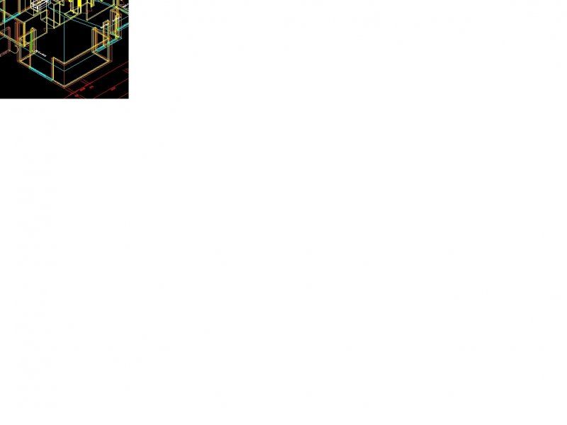

I would like to add the doors through Lisp.
I would like to add automatically something like the picture attached (yellow doors block).
Thanks in advance

I have just one door block and i scale/orientate it each time. The layer is on the dwg block
It is a consistent time consuming.
I would like to have something like:
1st click: at the beginning of the door
2nd click: end of the doors
3rd click: orientation
the block is attached on this post

One block? Put it on a tool palette. Easiest and quickest solution.
Yes, I have it on the tool palette. The ploblem is I have to scale and orientate it each time
Are you're drawings done to full size or are they drawn "to scale" as one might do on a drafting board?
BTW...your attachment above is invalid (i.e. - no good).
Full scale. bit the door opening/orientation are different and i need to adapt the block each time.

This lisp is just for orientations, not for scale. Is not helpful in my case.
Attached I add a new version of the block whit parameter
Rotate - Scale - Flip
door_smart.dwg
Are you aware of the align command?
It just expects 4 points, enter and Yes or No for scale.
I used align .... If the door are few it is ok... When i Need to add 60 different door it is a time consuming . I made a dinamic bock but is still a slow method

You just need to specify 2 points, hit Tab key and Enter when done.
If you have a look at this image its done by slicing out a section of the wall and then inserting the door details all in 2D+. The width is just input. Its asks for a start point and a direction swing in or out draws the door jamb. Now its copy righted so no code but the total package still exists if you want more info send me a PM.
If I was to redo this task I would use a dynamic block door so much easier to resize.
