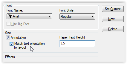

Yes, I posted a question some time ago and some dynamic block solutions were offered, my question was answered in a different way. Try search BIGAL dynamic block etc I will try to find.
Try this first using annotative text.

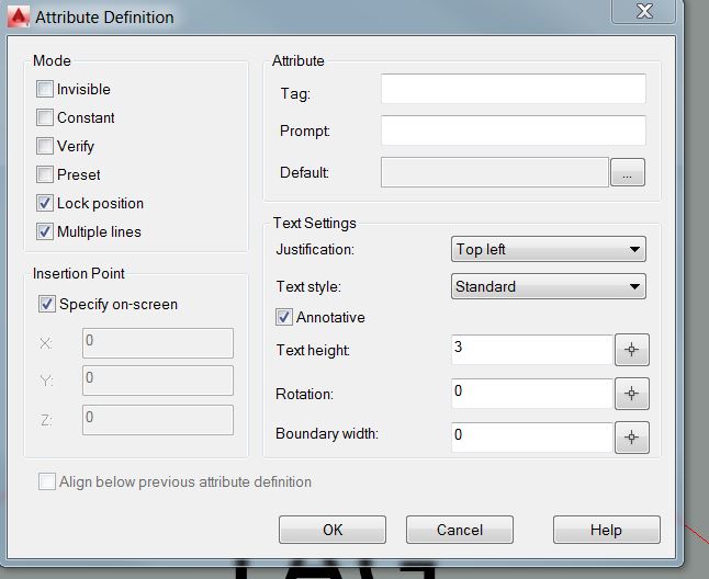

Hello BIGAL,
Thank you for your answer!
Where can I found this settings? Is it working with attriboute as well?
If I use att command I ahave this settings only:
