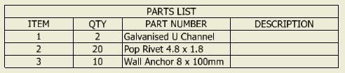

I created a steel profile (Galv. U Channel) and added 2 variations of fasteners as Virtual Components. I did this by creating one and then patterning them to the required quantity.
When I add one of these sections as a view in my .dwg and create the Part List the data populates fine (See below)

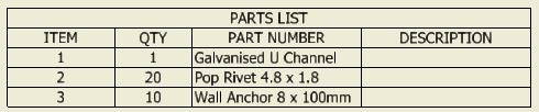

However when I have more than one of the profiles in the view the fastener quantities don't update. (See below)
Where am I going wrong?

Thanks czc, no I hadn't seen that post, however it doesn't really address my problem.
The U Channel I am using in the example is a fixed length and therefore I will always require a fixed number of fasteners per length. I just need that number to multiply by the amount of U Channel.
Further to this when I add other steel sections which use the same fastener I need my part list to sum them automatically.

So I resolved this issue this morning, I had not enabled the parts view in my BOM. In my defence I had warned that I was a new IV user.
It is now working as I expected.
