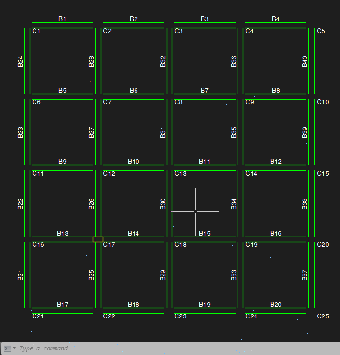

Grrr Posted November 25, 2016 Posted November 25, 2016 Thanks guys! I'm kinda ashamed that it was my fault overall Sorry structo, this should work now (alternatively to ziele_o2k's version) : (defun C:test ( / SSX f acDoc opn row LstRows i TxtLst b ) (if (and (setq SSX (ssget "_X" (list (cons 0 "TEXT") (if (= 1 (getvar 'cvport)) (cons 410 (getvar 'ctab)) '(410 . "Model"))))) (or (setq f (findfile "Test file.csv")) ; suit the filename and put the file within the trusted paths (setq f (getfiled "Select CSV File" "" "csv" 0)) ) ) (progn (repeat (setq i (sslength SSX)) (setq TxtLst (cons (entget (ssname SSX (setq i (1- i)))) TxtLst))) (if (and (setq LstRows (LM:readcsv f)) TxtLst) (progn (setq acDoc (vla-get-ActiveDocument (vlax-get-acad-object))) (vla-EndUndoMark acDoc)(vla-StartUndoMark acDoc) (vlax-map-collection (vla-get-Layers acDoc) (function (lambda (o) (vla-put-Lock o :vlax-false)))) (foreach a (mapcar 'list (mapcar 'cadr LstRows) (mapcar '(lambda (x) (strcat "(" x ")")) (mapcar 'cadddr LstRows))) ; column B and D (foreach b TxtLst (and (= (car a) (cdr (assoc 1 b))) (entmod (setq b (subst (cons 1 (apply 'strcat a)) (assoc 1 b) b))) (entupd (cdr (assoc -1 b))) ) ) ) (vla-EndUndoMark acDoc) ) ) ) ) (princ) );| defun |; (vl-load-com) (princ) ;; Read CSV - Lee Mac ;; Parses a CSV file into a matrix list of cell values. ;; csv - [str] filename of CSV file to read (defun LM:readcsv ( csv / des lst sep str ) (if (setq des (open csv "r")) (progn (setq sep (cond ((vl-registry-read "HKEY_CURRENT_USER\\Control Panel\\International" "sList")) (","))) (while (setq str (read-line des)) (setq lst (cons (LM:csv->lst str sep 0) lst)) ) (close des) ) ) (reverse lst) ) ;; CSV -> List - Lee Mac ;; Parses a line from a CSV file into a list of cell values. ;; str - [str] string read from CSV file ;; sep - [str] CSV separator token ;; pos - [int] initial position index (always zero) (defun LM:csv->lst ( str sep pos / s ) (cond ( (not (setq pos (vl-string-search sep str pos))) (if (wcmatch str "\"*\"") (list (LM:csv-replacequotes (substr str 2 (- (strlen str) 2)))) (list str) ) ) ( (or (wcmatch (setq s (substr str 1 pos)) "\"*[~\"]") (and (wcmatch s "~*[~\"]*") (= 1 (logand 1 pos))) ) (LM:csv->lst str sep (+ pos 2)) ) ( (wcmatch s "\"*\"") (cons (LM:csv-replacequotes (substr str 2 (- pos 2))) (LM:csv->lst (substr str (+ pos 2)) sep 0) ) ) ( (cons s (LM:csv->lst (substr str (+ pos 2)) sep 0))) ) ) (defun LM:csv-replacequotes ( str / pos ) (setq pos 0) (while (setq pos (vl-string-search "\"\"" str pos)) (setq str (vl-string-subst "\"" "\"\"" str pos) pos (1+ pos) ) ) str ) Quote
BIGAL Posted November 25, 2016 Posted November 25, 2016 1st up well done guys, the method not looked at for this task was Getexcel.lsp this allows direct access to excel rather than a csv it uses row,column for cell addresses making I want D not E etc easy to change. Grr just a suggestion bit easier if you want column G (setq LstRows (mapcar 'car (LM:readcsv f))) (setq LstRows (nth x (LM:readcsv f))) ; remember x column is -1 as nth starts at 0 Quote
Grrr Posted November 25, 2016 Posted November 25, 2016 1st up well done guys, the method not looked at for this task was Getexcel.lsp this allows direct access to excel rather than a csv it uses row,column for cell addresses making I want D not E etc easy to change. Grr just a suggestion bit easier if you want column G (setq LstRows (mapcar 'car (LM:readcsv f))) (setq LstRows (nth x (LM:readcsv f))) ; remember x column is -1 as nth starts at 0 Thanks BIGAL, I didn't knew about GetExcel.lsp, but IMO nothing can be more flexible than LM's matrix lists. I also thought about writing a subfunction to get directly row or column: ; key - from "A" to "Z" ; f - filepath (return from functions like getfiled/findfile) (defun GetColumn ( key f / Lst Column ) (setq Lst (mapcar (function (lambda (x) (cons x (vl-position x Lst)))) (setq Lst (mapcar 'chr (vl-string->list "ABCDEFGHIJKLMNOPQRSTUVWXYZ"))) ) ) (setq Column (mapcar (function (lambda (x) (nth (cdr (assoc key Lst)) x))) (LM:readcsv f))) ) _$ (setq ColumnD (GetColumn "D" (getfiled "Select CSV File" "" "csv" 0))) ("D1" "D2" "D3" "D4" "D5" "D6" "D7" "D8" "D9" "D10" "D11" "D12" "D13" "D14" "D15" "D16" "D17" "D18" "D19" "D20") _$ Row is easy as you mentioned. Quote

structo Posted November 26, 2016 Author Posted November 26, 2016 Hi friends, thank you all for great contribution of this thread. every one well executed to solving of task. my final request is my actual data file is in .xlsm format. any tweak for directly extract from excel file to cad, instead of .csv format? please tweak. Thank you guys. Quote
ziele_o2k Posted November 26, 2016 Posted November 26, 2016 Hi friends, thank you all for great contribution of this thread. every one well executed to solving of task. my final request is my actual data file is in .xlsm format. any tweak for directly extract from excel file to cad, instead of .csv format? please tweak. Thank you guys. BIGAL wrote solution in post above your - GETEXCEL.LSP Quote
structo Posted November 26, 2016 Author Posted November 26, 2016 BIGAL wrote solution in post above your - GETEXCEL.LSP hi zie, i saw your link. how to adopt or combine with grr's code? Thank you. Quote

BIGAL Posted November 29, 2016 Posted November 29, 2016 Just for anyone looking ; 2 lines of code (LOAD "C:/Alans_stuff/LISPS/GetExcel.lsp") (GetExcel "C:\\acadTemp\\Test.xlsx" "sheet1" nil) ; result is variable list *ExcelData@ (("GRP" "BLS numbers" "Type" "Size") ("" "" "" "(inch)") ("G1" "B1" "Reg" "9\"x4½\"") ("" "B2" "Reg" "12\"x12\"") ("" "B3" "Reg" "9\"x3\"") ;using the list can do the text matching Quote
structo Posted November 29, 2016 Author Posted November 29, 2016 Hi Bigal friend, thank you for great execution. how to use above code or how to combine Grr's code and your code? please post full lisp. thanking you. Quote
Grrr Posted November 29, 2016 Posted November 29, 2016 Here you go (it looks for .xlsm): (defun C:test ( / SSX fpath acDoc opn row LstRows ExelRange i TxtLst b ) (setq fpath (findfile "Test file.xlsm") ; suit the filename and put the file within the trusted paths ExelRange "D42" ; adjust the column-row range in the excel file (read up to that cell), for this example is "D42" ); setq ;;; dont set a high value like "XYZ123", since it affects the performance speed (if (and GetExcel (setq SSX (ssget "_X" (list (cons 0 "TEXT") (if (= 1 (getvar 'cvport)) (cons 410 (getvar 'ctab)) '(410 . "Model"))))) (or fpath (setq fpath (getfiled "Select xlsm File" "" "xlsm" 0))) ) (progn (repeat (setq i (sslength SSX)) (setq TxtLst (cons (entget (ssname SSX (setq i (1- i)))) TxtLst))) (if (and (setq LstRows (GetExcel fpath nil ExelRange)) TxtLst) (progn (setq acDoc (vla-get-ActiveDocument (vlax-get-acad-object))) (vla-EndUndoMark acDoc)(vla-StartUndoMark acDoc) (vlax-map-collection (vla-get-Layers acDoc) (function (lambda (o) (vla-put-Lock o :vlax-false)))) (foreach a (mapcar 'list (mapcar 'cadr LstRows) (mapcar '(lambda (x) (strcat "(" x ")")) (mapcar 'cadddr LstRows))) ; column B and D (foreach b TxtLst (and (= (car a) (cdr (assoc 1 b))) (entmod (setq b (subst (cons 1 (apply 'strcat a)) (assoc 1 b) b))) (entupd (cdr (assoc -1 b))) ) ) ) (vla-EndUndoMark acDoc) ) ) ) (cond ((not GetExcel) (alert "\nGetExcel.lsp is not loaded, load it first and try the routine again!")) ((not SSX) (alert "\nNo \"TEXT\" entities are found on the current tab.")) ((not fpath) (alert "\nThe \".xlsm\" file is not found nor specified.")) ) ) (princ) );| defun |; (vl-load-com) (princ) And you still need to download and load GETEXCEL.LSP. And you might want to adjust this part of the code for your needs (it currently suits the example): (setq fpath (findfile "Test file.xlsm") ; suit the filename and put the file within the trusted paths ExelRange "D42" ; adjust the column-row range in the excel file (read up to that cell), for this example is "D42" ); setq ;;; dont set a high value like "XYZ123", since it affects the performance speed Quote
