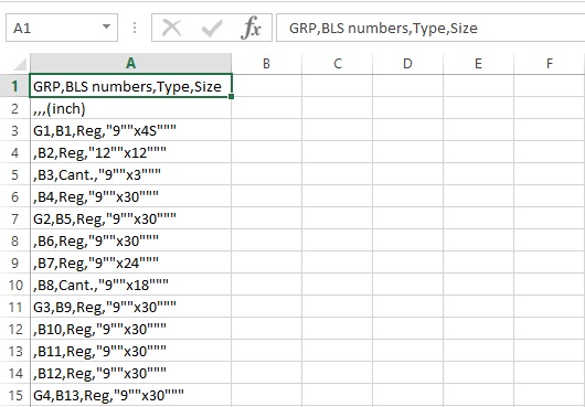

Hi friends,
i need add text from excel file to cad drawing lisp routine. read drawing text and excel file text, if matches paste relevant from excel to cad.
for example: my drawing text contains "B2" and my excel file at "D" column contains "B2" text then paste value from "E" column of excel file to Cad drawing beside B2 Text.
please find sample files of Cad and Excel files.

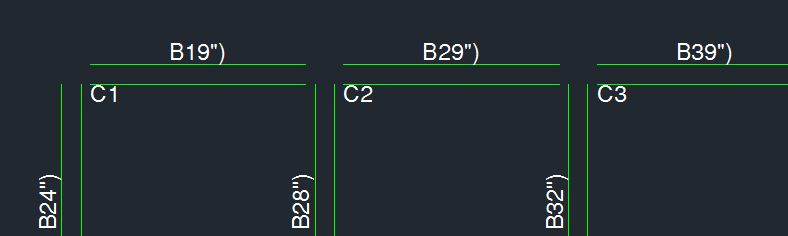

Dear friend,
i followed your rules but developing "reg" instead of sizes like 9"x18". and missing Brackets after text.example:B1(9"x4½") format.
Thank you.

Dear friend,
Text was formed as shown in image.
here i have attached correct format of csv file. please test. your post#7 is better than post#10 please provide final version of code.
Thanking you.

You said that the text should be extract from column "B" instead of column "A", but your in last attached .csv file the text is located in column "A".
Based on your decision change this line of the code in post #10 :
(setq LstRows (mapcar 'cadr (LM:readcsv f)))
To:
If you want to extract from column "A" (this worked on your lastly uploaded files):
(setq LstRows (mapcar '[color="red"]car [/color](LM:readcsv f)))
If you want to extract from column "B":
(setq LstRows (mapcar '[color="red"]cadr [/color](LM:readcsv f)))
If you want to extract from column "C":
(setq LstRows (mapcar '[color="red"]caddr [/color](LM:readcsv f)))
And so on...
oh sorry friend, that modification of csv file is unfortunatly happened. i apologies for my mistake. i will try your latest code and give feedback.
Thanking you for your kind support.

Could you atleast upload a screenshot to see what looks like inside of your csv, instead of upploading it.
Like this (currently what I'm seeing):
So I we could have an idea what we're dealing with (as I feel that I totally misunderstood the task, because of the provided .csv file).
Obviously the OP wanted you to provide him with what he needs and not what he asked for. Two different things no?
This looks like the reason why OPs are not answered that easily on their requests, because of the unclear questions/provided files.
Although his task is solvable, why need to spam 2-3 pages more only to understand what the real need is.
Here you can see a simple request, until we found that actually we have to deal with corrupt geometry instead of "rectangle" objects.
"I want small changes" is a different thing (which is not a problem IMO).

Anyway, to concatenate column "B" with column "D":
(if (setq LstRows (LM:readcsv f))
   (setq LstRows (apply 'append (mapcar '(lambda (x) (list (nth 1 x) (nth 3 x))) LstRows)))
But still won't solve the issue, because I have to remove the string re-formatting from the code - and to do so I firstly have to know what string to manipulate from the csv to be filled into the text entities.
Edited by Grrr
