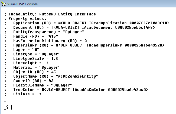

Wimal The objects are
AECC_POINT Layer: "0"
Space: Model space
Handle = 472
Text Location : (321447.34, 9944110.55, 0.00)
Text Rotation :
Normal : (0.00, 0.00, 1.00)
Group Name :
Point Number : 372
Point Name :
Northing : 9944110.55
Easting : 321447.34
Elevation : 1468.81 XDRef:
Raw Description : NYCS0071 XDRef:
Full Description : NYCS0071
Marker Location : (321447.34, 9944110.55, 0.00)

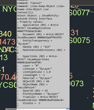

As I have CIV3D its ok, what do you get if you use this please post, just copy and paste to command line.
(vlax-Dump-Object (vlax-Ename->Vla-Object (car (entsel))))

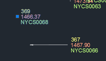

Thanks Mr.Bigal I run it with autocad 2016.
After open it with civil 3D
When I select it , Hilihhting the the insertion point.
When I move it Automatically generating an Arrow Directing the insertion point..
But I cant get value of insertion point.
Somebodymust have a solution.
