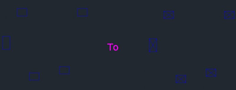

Hi friends,
i have rectangles and develop diagonal lines for selected rectangles as shown in figure.
Thank you all in advance.

thank you for your great support. please test with this drawing. cross lines are not developed.
Thanks.

Hi friend, thank you for modification. cross lines are not developed. please test your code with my sample file.
Thanks.

There seems to be an extra line of length zero at each corner of your rectangle.
That is what i meant by "other" rectangles, may not be closed or rotated at 0/90. not necessarily 4 vertices.....

Sorry friends,
just i saw my drawing. yes there is zero length lines at each corner. these rectangles are taken from one other software output. please ignore those zero length lines to develop diagonal lines by lisp.
Thank you all.

Dear friend pBe,
now your code is perfect working. thank you for your kind help.
Thanking you all for supporting.

			(and
				(= "AcDbPolyline" (vla-get-ObjectName eo))
				(vlax-curve-isClosed eo)
				(= 4 (vlax-curve-getEndParam eo))
				(equal ; opposite sides are equal AB-CD, will accept non-curved arcs/bulges
					(apply '- (mapcar '(lambda (x) (vlax-curve-getDistAtParam eo x)) '(1 0)))
					(apply '- (mapcar '(lambda (x) (vlax-curve-getDistAtParam eo x)) '(3 2)))
					fuzz
				(equal  ; opposite sides are equal BC-AD, will accept non-curved arcs/bulges
					(apply '- (mapcar '(lambda (x) (vlax-curve-getDistAtParam eo x)) '(2 1)))
					(apply '- (mapcar '(lambda (x) (vlax-curve-getDistAtParam eo x)) '(4 3)))
					fuzz
				(equal ; diagonals are eq length (not romboid) dist A C = dist B D
					(apply 'distance (mapcar '(lambda (x) (vlax-curve-getPointAtParam eo x)) '(1 3)))
					(apply 'distance (mapcar '(lambda (x) (vlax-curve-getPointAtParam eo x)) '(2 4)))
					fuzz
	(T nil)
rtn
);| defun Rectangle-p |; (or vlax-get-acad-object (vl-load-com)) (princ)
Although It won't support lookalike LWpolyline rectangles like in the OP's dwg. (sorry)
A quick edit.
Thanks pBe - I would have opted for the same modification given the OP's corrupted rectangles.
