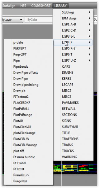

A couple of suggestions
If you running this a a macro then make it ^c^c^c(load "plotroutine") so it loads a lisp.
Have a look at a prefilled dialouge you can put the current value into the boxes and check for any that have not been filled in and ask the question continue or exit completey, the continue will open the dialouge again the exit is just that use (exit) it will end the lisp.
Re dialouge you can have say 3 lists so the user can choose the correct option. Me I just have multiple options in a menu so users picks what they want.
