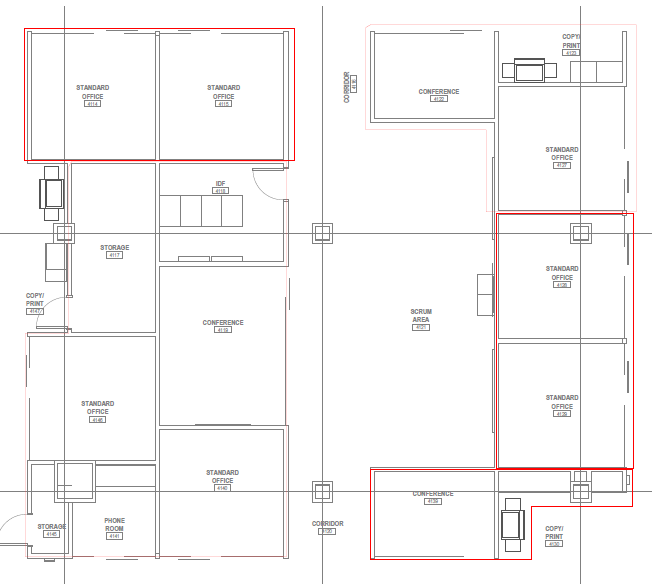

Jessica28 Posted November 19, 2016 Posted November 19, 2016 Hi, I am running AutoCAD MEP 2016...I am wondering if there is a way to make a viewport from model space that automatically appears in paperspace...Does that make sense?.....Basically I am working on floor plans and need to make individual sheets for every single room.. Thanks, Jess Quote

Jessica28 Posted November 19, 2016 Author Posted November 19, 2016 Thanks for the info tzframpton.... I can see how the project navigator can be of use...Is there something quick and easy though...I'll get a floor plan and will be asked for a quick layout and cutouts for specific areas...It would be nice to just be able to create rectangles and polylines and have a command that turns them into sheets automatically...I've attached an image of a basic office layout in 2D which is what we work with mostly for this task...Right now what I have been doing is making all these rectangles and plines in layout on top of the overall viewport of the floor plan..Then copy it several times and do a VPclip for every one....Makes me crazy!! Lol....Could the project navigator really help for this?.. maratovich..Thanks for the link. I clicked around that link and ran into a youtube video that looked like it created the viewport....Watching it on my phone though because I'm at work and company computers cant access youtube...Where would I get something like that to try out? Jess Quote

BIGAL Posted November 20, 2016 Posted November 20, 2016 A simple manual way In model space use ID pick a point about middle of view reuquired I cut paste to notepad (I have it on my windows taskbar) and paste then make it x,y copy again Make/copy layout with your title block have a mview created etc go to mspace Z E or zoom rough floor area required Then just Z C paste x,y 4xp The 4xp for me would centre the window at the point x,y at a scale of 1:250 as I am metric but the same can be done for feet. Yes you can put together a lisp that uses the same method. I have something but its part of a copyrighted package but will think about rewriting a generic one as so many recent posts ask for this but seem to produce a extremely complex solution rather than a quick and dirty solution. The one I have asks for the 5 views of an object top, front etc used for 3d house plans. Quote
BIGAL Posted November 20, 2016 Posted November 20, 2016 This is quick and dirty and still needs a little bit of manual work at end drag mview, but will do 95% of whats required, based around having a known title block in a layout. ; By Alan H Nov 2016 based on a metric answer. (DEFUN C:MVWIN ( / MP1 MP2 AND DIST PT SC3) (setvar "tilemode" 1) (setq mp1 (getpoint "\nLower left corner of window:")) (setq mp2 (getcorner mp1 "\nUpper right corner of window:")) (setq ang (angle mp1 mp2)) (setq dist (distance mp1 mp2)) (setq pt (polar mp1 ang (/ dist 2.0))) (setvar "tilemode" 0) (command "_.pspace") (command "_.ZOOM" "ALL") (initget 6 "Yes No") (setq ans (getkword "\nDoes mview exist? (Y/N)")) (if (/= ans "Yes" ) (princ) (progn (setq mp1 (getpoint "\nLower left corner of window:")) (setq mp2 (getcorner mp1 "\nUpper right corner of window:")) (command "_.mview" mp1 mp2) ) ) (command "_.mspace") (setq sc3 (strcat (RTOS (/ 1000.0 (getreal "\nScale for this window 1: "))2 3 ) "XP")) (command "_.zoom" "_center" (strcat (rtos (nth 0 pt) 2 3) "," (rtos (nth 1 pt) 2 3)) sc3) ) (C:MVWIN) Quote

ReMark Posted December 5, 2016 Posted December 5, 2016 Take a look at Lee Mac's custom lisp routine called Viewport Outline. Maybe you can use it in some manner. http://lee-mac.com/vpoutline.html Quote
maratovich Posted December 5, 2016 Posted December 5, 2016 Jessica28 Attach your file .dwg. Specify how you want the result. Quote
