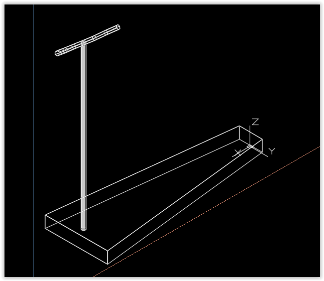

This is a suggestion based on Autocad not inventor but may be usefull, you make 1 single tread as a spiral stair case is made of multiple treads, the hand rail is basicly the only thing that is on a spiral. You can create this by seeting your UCS to the correct plane angle for the rise, then draw an arc, and extrude the handrail shape along the arc. Then copy rotate and move vertical.
