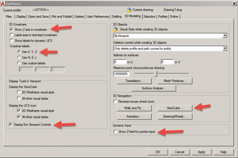

Here are a few settings you may want to know about and get setup, or at least explore.

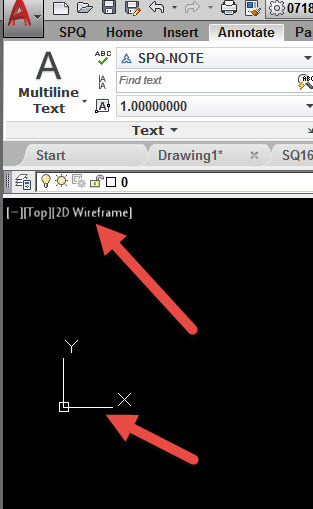

Viewport Controls which can be set to show on your graphics screen in the upper left. Shows you the visual style you are currently using, like 2D, Realistic, etc, and lets you choose others, click on it and pick from the drop down. The other part shows you the various preset views like SE Isometric, Top, etc. Pick on that and a drop down list lets you change to another view. Further left you will see[+], pick on that for a few menu items you may want to use.
UCSicon - always have it on. If it is showing as a stick figure then you are in 2D visual style, if it shows up as a 3D image then you are in a visual style other than 3D. The UCS is selectable, pick on it once and grips appear, grab the origin grip to move the UCS, grab the X grip and you can rotate the UCS to allow you to work on another plane. Find the Dynamic UCS icon at the bottom center of the screen, you can toggle that off or on. On will allow you to draw on a plane as you move your cursor over the object.
Learning to manipulate the UCS is (IMO) one of the main things to learn how to do well in order to succeed at 3D. It is easier now that we have Dynamic UCS (DUCS) but I find I need to manipulate it a lot. The UCS manipulation will help with your 2D drafting a lot as well, so it is worth knowing how to manipulate.

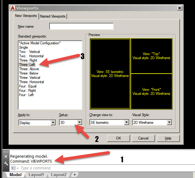

VIEWPORT command to have more than one view of the 3D object, like a SW view, top and front view, etc. As you get more comfortable with 3D you may find you don't use that as much as before.
I would recommend using the Ribbon for 3D work, set the Workspace to 3D and find a large number of the commands easy to locate.
See images attached. I will add one more in another post.
