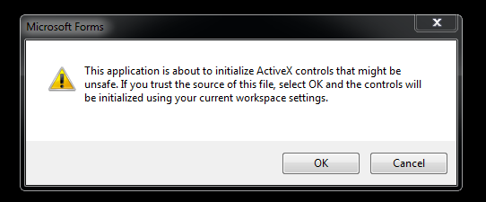

I currently use AC 2008 along with a program called SteelLogic. The person that created this program is no longer in the business and doesnt support the program (add-on).
Whenever I open Autocad I get a message Microsoft Forms. "This application is about to initialize ActiveX controls that might be unsafe....."
Does anyone know how I can disable this message or disable ActiveX warnings? I know how this would work in MS applications but cannot figure it out for AutoCad.
Thanks in advance.

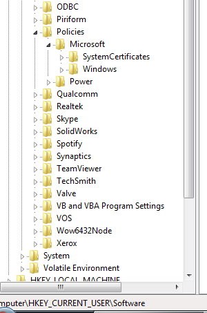

Thanks. I will check it out this evening and let you know.
I don't have VBA in Software\Policies\Microsoft\

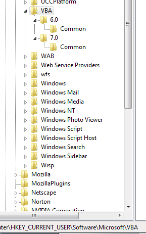

I do have VBA here:
Software\Microsoft\VBA

I don't have a directory here:
But there is a VBA folder here:
Software\Microsoft
You may need to create both folders. Did you read the link I posted and follow the instructions?
You may have to check for a more recent fix. Do you still have any older MS Office products?
Be sure to create a restore point and backup the registry.
