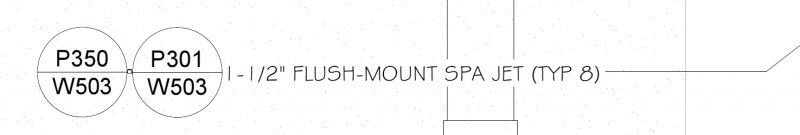

Kremer Posted November 17, 2016 Author Posted November 17, 2016 The attachment shows the...unnerving attempt at trying to reduce the size of the selection leader. Ideally, we could have just the detail callout without the need to hide the leader. I really need to get the terminology down, but I hope this makes it a bit more clear. Quote
tzframpton Posted November 17, 2016 Posted November 17, 2016 Ah, I see. I would opt for using View Reference instead. Which, will still be a change of standards, but like we've mentioned before, sometimes that's necessary. Help File: https://knowledge.autodesk.com/support/revit-products/learn-explore/caas/CloudHelp/cloudhelp/2015/ENU/Revit-DocumentPresent/files/GUID-A2E20369-8B83-4BE8-A4CF-2784D66F9A6A-htm.html Keep in mind, you can always use a Generic Annotation family and just manually input the Sheet Reference, as you would in AutoCAD. But then you lose the auto-referencing feature. Or, if you must keep the auto-referencing, you can use Elevations as "dummy callouts" by creating a new Section and Callout Head Family with no Section Arrow and using the Reference View feature. But, it will be a heavy workaround, and if it becomes a habit it'll be hard to break. -TZ Quote
Kremer Posted November 17, 2016 Author Posted November 17, 2016 We just checked out the view references and I'm almost positive that'll be the route we take. Many thanks as always! Hope you have a nice evening. Quote
