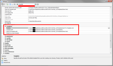

Dahzee Posted November 14, 2016 Posted November 14, 2016 Paulmcz, I have attached a file showing you the template location on my system for V15. To get to the attached dialog box, type settings on the command line and then in the box I have underlined type "basefile". This will then show you what is in the Red Frame so you see where you need to put your own .dwt file. You can also type in "startup" in the box I underlined and this will will give you a couple of choices to what Bricscad shows you when you first start the program. If you need any more assistance please let me know and I will try to help. Alternatively you can go to the Bricscad Forum https://www.bricsys.com/common/support/forum.jsp. Choose which platform you need (Windows, Mac, Linux) and then post there, you will get help from users and people from Bricsys themselves. Hope this helps, Dahzee Quote

paulmcz Posted November 14, 2016 Author Posted November 14, 2016 Paulmcz, I have attached a file showing you the template location on my system for V15. To get to the attached dialog box, type settings on the command line and then in the box I have underlined type "basefile". This will then show you what is in the Red Frame so you see where you need to put your own .dwt file. You can also type in "startup" in the box I underlined and this will will give you a couple of choices to what Bricscad shows you when you first start the program. If you need any more assistance please let me know and I will try to help. Alternatively you can go to the Bricscad Forum https://www.bricsys.com/common/support/forum.jsp. Choose which platform you need (Windows, Mac, Linux) and then post there, you will get help from users and people from Bricsys themselves. Hope this helps, Dahzee Thank you. I already tried all that. It somehow doesn't work for me. Quote

Dahzee Posted November 15, 2016 Posted November 15, 2016 Paulmcz, There is obviously something going on with how Bricscad has been setup on the system you are babysitting, so you can file a support request with Bricscad, even if you were only trialling the software they will still respond to support requests. Either that or download the latest trial of V17 (I think the .dwg version is still the same), it doesn't overwrite your previous version and if this is only a temporary job for you as long as it takes less time than the trial allows you can get the job done. Quote
