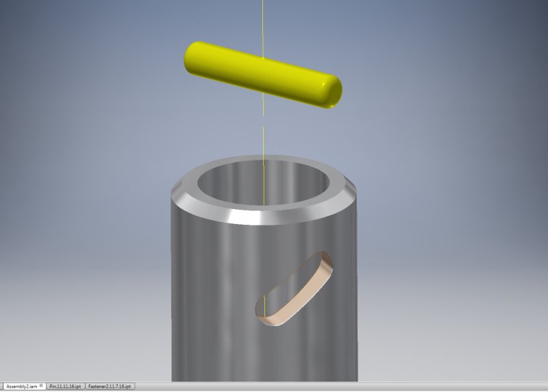

I've been searching Google for what feels like days now, watching YouTube videos and trying nearly every possible constrain combination that I know of, yet I'm no further than where I began. Hopefully someone can shed some light on this dilemma for me :D
I've attached a couple screen shots that with any luck will make the explanation easier to follow.
The goal is to constrain the pin to ride in the groove in the cylinder that has been made using the emboss feature. There is another cylinder that the pin will be constrained to (for ease of explaining I'll call it a bolt) so when the bolt is turned to the left, the pin and the bolt will ride up the groove and vice-versa.
I've tried the transitional constraint, played with the minimum and maximum limits along with every possible combination in the standard constrain menu but I've come to a dead stop.
Anyone have any ideas? Any help or ideas are greatly appreciated! Thank you! :notworthy:

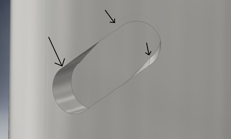

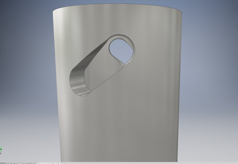

I was able to get the coil figured out, but speaking of drawing parts as they are to be machined, I'm having a difficult time visualizing this being correct.
Where the coil meets the circular extrusions it doesn't appear to line up in a way that will make the path smooth for a tool to cut the part. It seems like the faces don't meet up correctly and it's actually representing how it is to be cut, if that makes any sense. I've also tried using slightly larger and smaller dimensions on the path that's used for the coil, still no luck having the faces line up.

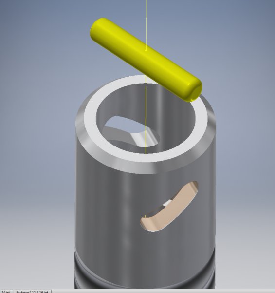

I'm going to try experimenting with another idea I have for the groove. Any opinions or views on the picture?
asset.php?fid=56756&uid=164758&d=1480561060
Another way to draw is attached. Extrude holes, draw line perpendicular to hole from center, surface sweep line at height and angle, thicken. This allows for a good tangent constraint. Create plane on bottom of hole, constrain with min/max limits.
Assembly1a.zipFetching info...
I did a sweep this time and it seemed to slightly improve. I'll have to do an experiment and have it machined. Thanks again kpyoung! Without you I'd still be digging through the weeds.
