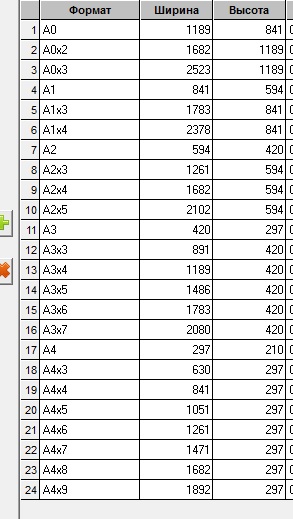

maratovich Posted November 22, 2016 Share Posted November 22, 2016 1. This multipolar world, you can do whatever you want. 2. Without creating dimensions, printing will not work. 3. You can use PDFCreator ? 4. Write to me - what the maximum and minimum dimensions for you? Quote Link to comment Share on other sites More sharing options...
reza Posted November 22, 2016 Author Share Posted November 22, 2016 1: you did not kidding do not joke with you I need to do with my lisp in each run, is to assign ΔX and ΔY of user-picked points of a layout block as dimensions of Custom paper size 2: (setq p1 (getpoint "\nPick first corner : ")) (setq p2 (getcorner p1 "\nPick the opposite corner : ")) (setq deltaX (abs (- (car p1) (car p2)))) (setq deltaY (abs (- (cadr p1) (cadr p2)))) 3: ok 4: minimum = Width 420 x Height 600 mm. maximum = Width 900 x Height 3000 mm. Quote Link to comment Share on other sites More sharing options...
maratovich Posted November 22, 2016 Share Posted November 22, 2016 1:minimum = Width 420 x Height 600 mm. maximum = Width 900 x Height 3000 mm. In your example indicated 850x140 140 - this will be? a step size of 1 mm? Quote Link to comment Share on other sites More sharing options...
reza Posted November 22, 2016 Author Share Posted November 22, 2016 (edited) that is absolutely example another example : 33+010 R.dwg Edited November 22, 2016 by reza Quote Link to comment Share on other sites More sharing options...
maratovich Posted November 22, 2016 Share Posted November 22, 2016 another example : It is becoming clearer. It's not a problem. You have a lot of drawings in model space ... You need to know the step size of the rectangle. See private message. Quote Link to comment Share on other sites More sharing options...
