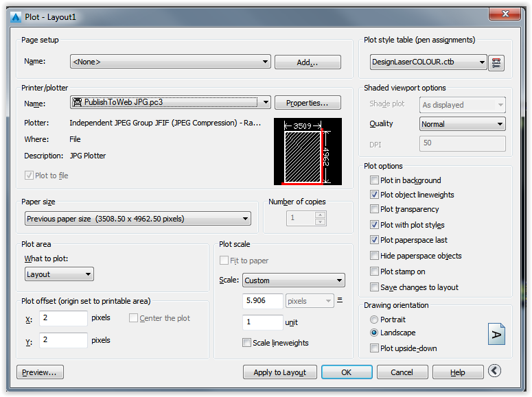

BIGAL Posted November 13, 2016 Share Posted November 13, 2016 If you are plotting from layouts using a title block that is the size you want then its simple just set up the correct plot commands, the example below expects the title block to be at 0,0 so no need for pick window as you know the size of the title block. You can do the same if the title block is not the size you want by adjusting the final layout plot scale do this for my TIFFS scale is 0.127 for a A1 sheet. This is example code highlighted in red is what you would change. (COMMAND "-PLOT" "Y" "" "[color="red"]\\N03\\laser-BW[/color]" "[color="red"]A3[/color]" "m" "LANDSCAPE" "N" "W" "[color="red"]-6,-6[/color]" "[color="red"]807,560[/color]" "1=2" "C" "y" "[color="red"]Designlaser.ctb[/color]" "Y" "N" "N" "N" "N" "N" "y" ) ) If your plotting in model space again you can plot all title blocks in one go. Quote Link to comment Share on other sites More sharing options...

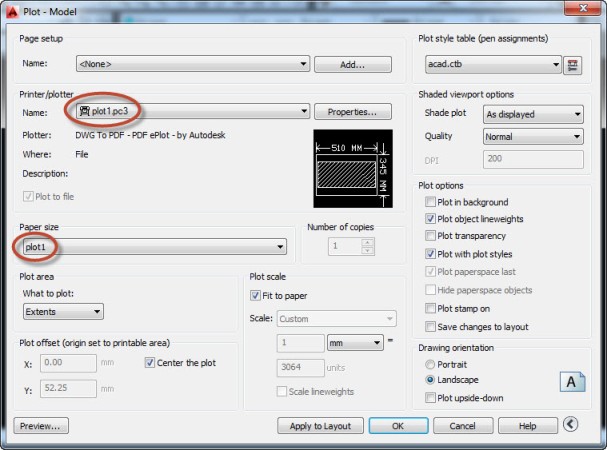

mostafa badran Posted November 14, 2016 Share Posted November 14, 2016 You can create your own PCE as per your paper size plot1,plot2,plot3...... and use the following. (setq pt1(getpoint"\nPick upper left corner: ")) (setq pt2(getcorner pt1 "\nPick lower right corne: ")) (setq pltyp "[color=red]plot1.pc3[/color]") (setq plstyle "acad.ctb") (setq plsize "[color=red]plot1[/color]") (command "-plot" "Yes" "Model" pltyp plsize "Millimeters" "Landscape" "No" "Window" pt1 pt2 "Fit" "Center" "Yes" plstyle "Yes" "No" "No" "Yes" "Yes" ) HTH. Quote Link to comment Share on other sites More sharing options...
reza Posted November 14, 2016 Author Share Posted November 14, 2016 Hi Mostafa it not work in Attachment Files (plot.dwg) (setq pt1(getpoint"\nPick upper left corner: ")) (setq pt2(getcorner pt1 "\nPick lower right corne: ")) (setq pltyp "plot1.pc3") (setq plstyle "acad.ctb") (setq plsize "plot1") (command "-plot" "Yes" "Model" Enter an output device name or [?] : plot1 not found. pltyp plsize "Millimeters" "Landscape" "No" "Window" pt1 pt2 "Fit" "Center" "Yes" plstyle "Yes" "No" "No" "Yes" "Yes" ) Enter an output device name or [?] : plot1 not found. I want add user paper size to list of paper size of "Dwg To Pdf.pc3" device Quote Link to comment Share on other sites More sharing options...
mostafa badran Posted November 14, 2016 Share Posted November 14, 2016 Did you create plot1.pc3 with custom paper size ? Quote Link to comment Share on other sites More sharing options...
mostafa badran Posted November 14, 2016 Share Posted November 14, 2016 This link helpful to add plot1.pc3 with custom paper size. HTH. Quote Link to comment Share on other sites More sharing options...
reza Posted November 14, 2016 Author Share Posted November 14, 2016 salam mostafa No I can not create plot1.pc3 with custom paper size Quote Link to comment Share on other sites More sharing options...
mostafa badran Posted November 14, 2016 Share Posted November 14, 2016 salam mostafa No I can not create plot1.pc3 with custom paper size This link helpful to add plot1.pc3 with custom paper size.HTH. So ,you can follow the previous post. Quote Link to comment Share on other sites More sharing options...
reza Posted November 14, 2016 Author Share Posted November 14, 2016 (edited) I create it : 1-Click Application menu> Print> Manage Plotters. 2-In the Autodesk Plotter Manager, double-click the Add-a-Plotter Wizard shortcut icon. but i can not create it with lisp code no problem Now: How to change paper size in added new plotter (PLOT1.pc3) with lisp code ? Edited November 14, 2016 by reza Quote Link to comment Share on other sites More sharing options...
mostafa badran Posted November 14, 2016 Share Posted November 14, 2016 (edited) I create it : 1-Click Application menu> Print> Manage Plotters. 2-In the Autodesk Plotter Manager, double-click the Add-a-Plotter Wizard shortcut icon. but i can not create it with lisp code no problem Now: How to change paper size in added new plotter (PLOT1.pc3) with lisp code ? Sorry I don't know it is possible in auto-lisp or not but I am trying/wait to another person to guide use . when I look to your sample I found 5 paper custom size if it's only 5 you can do it manually . Edited November 14, 2016 by mostafa badran correction Quote Link to comment Share on other sites More sharing options...
