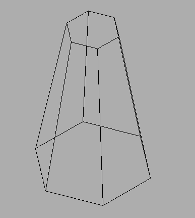

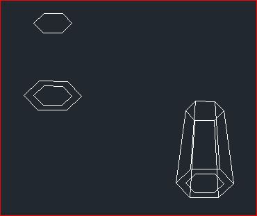

george74 Posted November 8, 2016 Posted November 8, 2016 Hello! I am total amateur in ACAD (still using 2000 edition), but it serve me well. But now I cam e to problem I can not solve - any help will be higly appretiated. I wish to make 3D object for my CNC router software - the object is CONICAL HEXAGON (it can also be conical box or conical cylnder etc). By conical I mean that bottom surface is larger then upper surface. Since I am not sure if this make sense I draw sample in ACAD - it is enclosed. On left is straight 3D hexagon I know how to draw - "6 corner polygon" command and then command "extrude". No problem. But if I want upper surface to be smaller and desing of hexagon conical I come to an end street - to be clear I draw something in ACAD that could explain what I mean ... Please look at the right thing on thepicture, but do know that this is not 3D object, it is nearly sample what I am looking for. Can anybody please help? This has been killing for me for a long time now. Thank you in advance, Gregor from Slovenia Quote
Cad64 Posted November 8, 2016 Posted November 8, 2016 Autocad 2000? Ok, I'm not really sure what commands are available in that old version, but when you run the Extrude command, do you get any options? Specifically "Taper Angle"? Run the Extrude command and watch your command prompt. After you select the hexagon and hit enter you should get some options. If "Taper Angle" is available, try using that. Quote
paulmcz Posted November 8, 2016 Posted November 8, 2016 When you are extruding the hexagon base, give it an angle it needs. Quote
paulmcz Posted November 8, 2016 Posted November 8, 2016 I'm not really sure what commands are available in that old version, but when you run the Extrude command, do you get any options? Specifically "Taper Angle"? Taper angle is available in A2000 Quote
george74 Posted November 9, 2016 Author Posted November 9, 2016 Hi, kind people Thank you so much for this ... I can not belive how easy it is once someone shows you. It worked in no time, but it was driving me crazy before. Thanks again, both of you!!!!!! All the best, Gregor Quote
Dadgad Posted November 9, 2016 Posted November 9, 2016 (edited) Welcome to CADTutor George74. Another easy way to do this, in later versions is as follows. After creating your Hexagon base, preferably it is a closed polygon. Use the OFFSET command, and read the commandline prompts. Select your hexagon base and specify the Offset distance, then click either inside or outside of it, to define the direction for the offset. Now you should have two concentric hexagons, on the same plane. Using an Isometric perspective, so you can better see what you are doing, MOVE one of them along the Z Axis, however far, and in whichever direction you wish. Now try using the LOFT command, read the commandline prompts, and you will learn another way to do it. I attached a screenshot. I copied the smaller hexagon up, before lofting, which is why you still see the smaller hexagon on the base plane, instead of moving it, as I described previously. There are lots of good tutorials available on the Tutorials tab, to help you learn the ropes. Have fun. Edited November 9, 2016 by Dadgad Quote

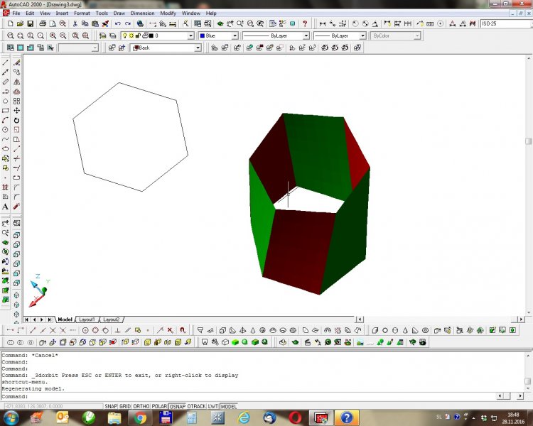

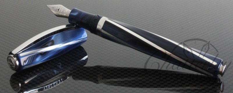

george74 Posted November 28, 2016 Author Posted November 28, 2016 Hello everybody! You have been so helpfull some time ago about my tapering problem - I am still very thankful. And please do not think that I am going here the easy way and write here as soon as I came to a problem - I have been dealing with following hexagon issue for quite some time. Unsuccsesfully I am afraid. Perhaps you might again be so kind to give me some pointer? Thank you!!!! What I am trying to do is draw in ACAD 2000 3D objects for my CNC router (I am making wooden parts for fountain pens). This time I wish to make (tapered or straight) hexagon, but not as simple as mentioned in my first email, but in a way that top would be rottated compared to bottom for certain angle. Let's say 60 degress. Since this might read strangely, I have found few photos on web showing the fountain pens I wish to make. Photos: 1. Heagon straight photo I am Ok wth. 2. But pen by Visconti has surfaced kind of curved in a way as a coil. Is there any way I can draw this in ACAD? I do not know any other software for drawing objects, so I would prefer to stay in ACAD. For any advice I thank you in advance. Sincerly, Gregor Quote
ReMark Posted November 28, 2016 Posted November 28, 2016 I'd call it more of a twist than a coil. Extrude with a twist? Quote
george74 Posted November 28, 2016 Author Posted November 28, 2016 Hi! My English is apperantly on even lower stage then ACAD, sorry ... Yeap, twist sounds more correct. Is there a way to do this in old versions of ACAD? Like really old? Like in ACAD 2000? Thanks so much for answer, ReMark Quote

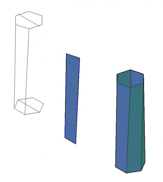

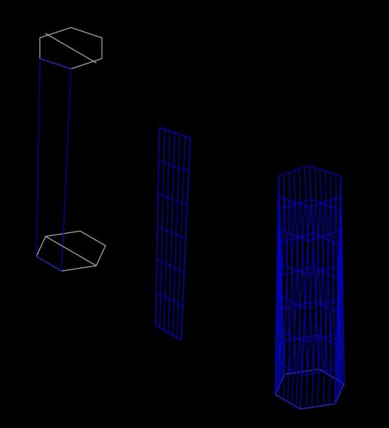

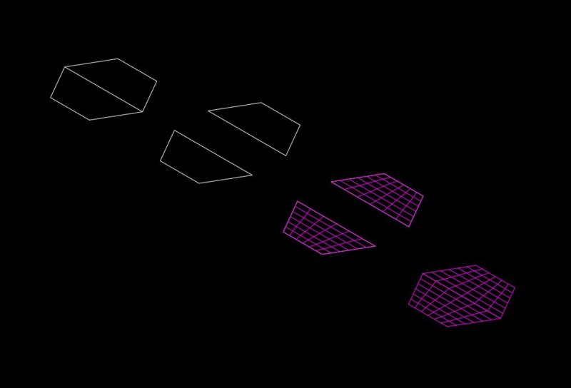

ReMark Posted November 28, 2016 Posted November 28, 2016 I don't exactly recall. For a moment there I thought the option to twist was available but now I am doubting myself. In versions that came later I would probably make a copy of the shape above the original, rotate it slightly (ex. - 15 degrees) then use the LOFT command. I'll have to see if I have my old AutoCAD 2000 book somewhere around my office to check on the Twist option (if it ever existed). Sorry, could not find any reference to a twist option as it pertains to the Extrude command. Most likely I had it confused with the taper option. You could replicate the feature using four lines and the EDGESURF command if you don't mind working with surfaces. Once you've done one side it would be just a matter of copying and rotating to fill in the other five sides. Quote
ReMark Posted November 28, 2016 Posted November 28, 2016 Here's what I was previously referring to re: EDGESURF. First image taken using a 2Dwireframe visual style; second image used a Conceptual visual style. Quote
george74 Posted November 28, 2016 Author Posted November 28, 2016 Hi, me again I finaly got it ... I think ... but not fully. I was able to copy top hexagon from bottom, rotate it and draw surfaces ... I even manage to copy and rotate it all around the hexagon .. But now I am again stucked. Would you please take one more moment to help? This think now is of course not solids, it need bottom and top surface. Is there any way I can make this happens? I have tried to use EDGESURF here also but it does not work on more then 4 edges?? I would just like to make a solid out of this surfaces (and perhaps get more new version of acad) and export it to .STL THANK YOUUUUUUUU Quote
ReMark Posted November 28, 2016 Posted November 28, 2016 FYI - This is how one can take a six sided polygon and create a surface. As regards your "solids" problem please attach a copy of a drawing that only contains the twisted hexagon shape you have shown above. We need a .dwg file not an image file. An image file at this time would be useless. Understand? Quote

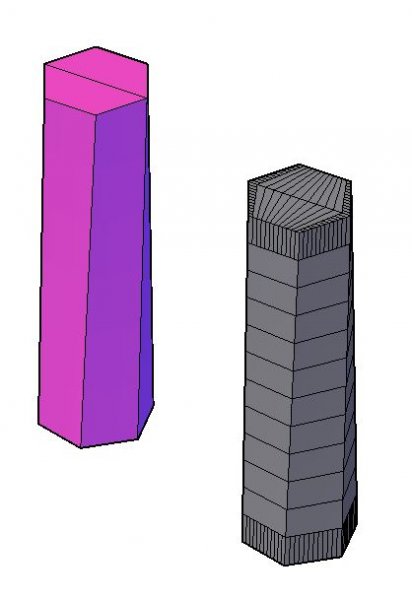

ReMark Posted November 28, 2016 Posted November 28, 2016 It is possible, in later versions of AutoCAD that have the SURFSCULPT command, to convert a "watertight" object comprised of multiple surfaces to a solid. In the example shown below the object on the left (magenta colored) is comprised of ten surfaces (6 sides and 2 pieces each for the top and bottom). The object on the right (gray colored) is the result obtained after running SURFSCULPT. Quote
george74 Posted November 28, 2016 Author Posted November 28, 2016 Hi! Thanks so much for your patiente, really appretaited. Thansk for the tip on hexagon surface, it worked here too But just when I thought that I was finished damn thing did not want to be exported as .STL (it said NO SOLIDS SELECTED). I guess Autocaf still does not take this as an solid object? But for sure I will asap move to higher autocad version. In 2000 is simply to much work to do by hand. Thank you once more, Gregor twist.dwg Quote
