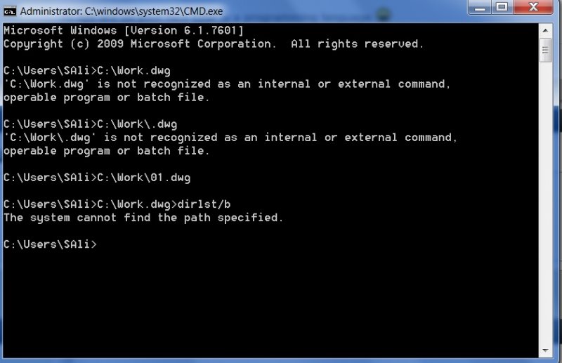

Sir,
thanks for your reply ,
please see the attachment it shows error , i am not much families with cmd , please put the full cmd command my file location is C:\Work and my drawing name is 01,02,03 etc
thank you

I would use Lee's script writer as he suggested but if you want the other way
CMD
CD\
CD work
dir *.dwg > dirlst.scr /b
exit
open Word
open dirlst.scr
press enter once need a blank line at top
use replace ^p with ^pOPEN <-space here
you should have Open dwg1
use replace ^p with (load "DEE.lsp" nil) (if DEE (DEE)) _.qsave _.close^p
remove 1st dummy line
close and save your script is done.

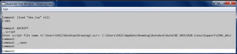

Sir,
Sorry for the doubt again :unsure:
1) i removed the 'qsave' 'close' in 'DEE.lsp' and i saved
2) I run 'Wsript' i copied the same in script line
3) i selected my directory
4) Now all of my drawing open and close automatically but 'DEE' lisp drawing not inserting :(
Please tell me which step i did mistake ,

Type (load "dee.lsp" nil) and you should see DEE on the command line otherwise its just not loading it must be in a directory that has been preset in you support paths else you will need to do something like (load "c:\yourlispsdirectoryhere\dee.lsp" nil)
Sir,
I did the same, i typed (load "dee.lsp" nil) and run leemac program now also, every drawing open automatically and close without any change dee.lisp
please see the attachment bellow
i know i do some mistake , but i can't figure out what is my mistake , please excuse me

In your DEE.lsp, I notice that your variable 'AV' is not defined - this will cause the Script to terminate.

How should I know what value to define it to use?
The variable is setting the attribute value for your block:
(command "insert" fname '(7.6911 3.3174) 1.4 "" 0 [highlight]AV[/highlight])
Here:
  • fname is the block
  • '(7.6911 3.3174) is the insertion point
  • 1.4 is the x-scale
  • "" means ENTER, i.e. use the x-scale value for the y-scale
  • 0 is the rotation
  • AV is a variable to set the attribute value
I would suggest the following changes:
(command "_.-insert" fname "_S" 1.4 "_R" 0.0 "_non" '(7.6911 3.3174) "YourAttributeValue")
However, this still assumes that ATTREQ=1 and that your block has only a single attribute. To avoid the attribute prompt altogether, simply set ATTREQ=0.

If you are changing ATTREQ to 0, you should not supply the attribute value:
(defun c:dee ( / fname )
   (mapcar 'setvar '("cmdecho" "insunits" "dimasz") '(0 4 3.0))
   (if (findfile (setq fname "c:\\hpc\\DE.dwg"))
       (command "_.-insert" fname "_S" 1.4 "_R" 0.0 "_non" '(7.6911 3.3174))
You also no longer require the ENTER & rotation responses, as these have already been supplied ("_S" 1.4 and "_R" 0.0).
Please take some time to study the comments in my posts, and also manually enter the prompts for the -INSERT command at the command-line so that you are aware of how your program works.
I see that you have also changed the function definition to 'c:dee', therefore, it will need to be evaluated as such:
_.open *file* (load "DEE.lsp" nil) (if c:DEE (c:DEE)) _.qsave _.close
