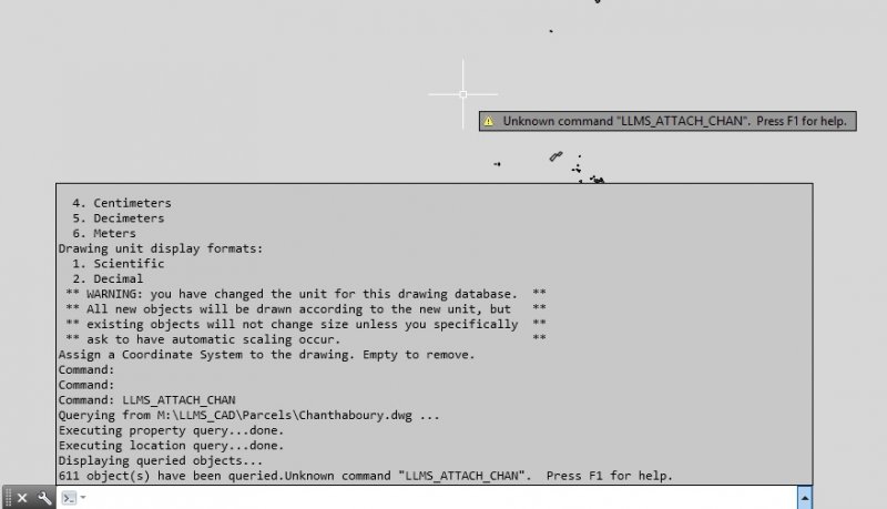

when I run code it was prompt this error
This is a error prompt:
>>Command: LLMS_ATTACH_CHAN
>>Querying from M:\LLMS_CAD\Parcels\Chanthaboury.dwg ...
>>Executing property query...done.
>>Executing location query...done.
>>Displaying queried objects...
>>611 object(s) have been queried.Unknown command "LLMS_ATTACH_CHAN". Press F1 for help.
