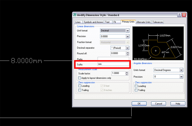

Anybody knows how to put a unit in a DIMLIN?
Ex: 100 m , 50 ft., 5 mm
