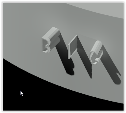

Is this what you had in mind just extruded the text and used rotate3d to position the text in a radial position.

How did you extrude arc aligned text? Or any text for that matter. Text cannot be extruded unless your explode it and the run the TXTEXP command, but if you explode his arc aligned text, it gets flipped and the font changes.

Thanks, I got it installed and it works fine for straight line text but it's not going to work in this case for arc aligned text. You would have to create each letter, one at a time, and then move and rotate them into position. I think my suggestion of WMFOUT and WMFIN might be a better solution.
Cad64 you are correct I made each letter individually. I had to modify after exploding the text so they were not just outlines. Once you have the library though its available for other projects. I over extruded and trimmed using a cricle then joined so the join was radial but outer edge was flat. If radial wanted then subtract using two circles.
