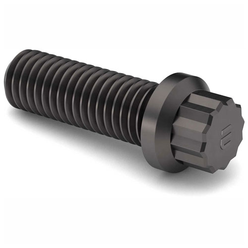

I know how you feel. Even worse, just after I upgraded to a few hundred bucks worth of six point sockets (twice as strong as the hobbyist 12 point socket) for my air wrench, the really good bolts now come like THIS! arrgh.:shock:
