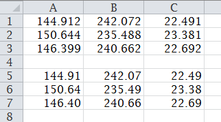

The difference comes about because the coordinates exported to the csv file have been rounded, whereas the coordinates in AutoCAD have not been rounded.
If you work like that, you have to expect slight differences.
The coordinates in AutoCAD to 4 decimal places are 9.9822 and 11.6967, which when subtracted give 1.7145 and when rounded give 1.71, (confirmed by dimension).
The figures in Excel are 9.98 and 11.70, which when subtracted give 1.72.

Thank you for your kind reply.with help of your modification at auto cad coordinate value showing again more than 3 digits like a "9.9822". but i need to discover coordinate to be set to 9.98 (round off to 2 digit precision) and same exact coordinate values should be exported to CSV. any lisp routine or lisp modification?
Thanking you,
Best regards.
I think that you will have to format cells in Excel to show 2 decimal places. Then when you save to a csv file, the numbers will be as you require.

i am trying for same in auto cad for 2 digits precision drawing. because i want to export my drawing to another software.there is not coincide my export excel drawing points and auto cad drawing. so please try for auto cad scaling from 4 digits to 2 digits precision and these should match auto cad coordinates and Export CSV points should be same. please find Post#1 in this thread.
