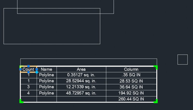

Does anyone know a routine that enables provide real-time the sum of areas of rectangles as you draw consecutively?
You can use Data Extraction for this. It provides real-time updating (granted, you have to manually Update the Table) but it will take each RECTANGLE, show the Area of each one, and you can add a footer that sums all the values.
I've tested it and it works:
