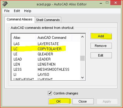

brooksdesign Posted October 20, 2016 Posted October 20, 2016 Hi, I rely on 2 letter alias to be productive. I would love to include the express tools into this format. Cant get my head around doing this, they dont execute. Pls advise, Thanks in advance for you advice. Quote
brooksdesign Posted October 20, 2016 Author Posted October 20, 2016 example= turn "copytolayer" into "lc" Quote
Dadgad Posted October 20, 2016 Posted October 20, 2016 (edited) Nothing to it, but to do it. Using the AliasEdit command is probably the easiest way. The acad.pgp - AutoCAD Alias Editor dialog will open. To create a new ALIAS, click on ADD. A new smaller dialog will open, wherein you will enter the NEW ALIAS which you want to create. After you do that, you can either scroll through the list of commands, or much quicker just type in the command name (cannot contain spaces), in this case COPYTOLAYER. When closing each dialog you will need to confirm your intention. Then your .pgp will have been customized to include the changes, assuming that you confirmed your desire to do so. A dialog may advise that the changes have been made, and will be available in your next Autocad session. You don't need to shut down Autocad, just enter REINIT at the commandline, then click the PGP box in the dialog. after you close that dialog your new Alias should be working. See the screenshot for a visual. I am partial to using multiple strikes on one key for most of my aliases. My left hand default position, has one finger on the ESC key, and covers most of my frequently used aliases. I really like taking advantage of the TILDE key, which I never need in my work, so a single click is MOVE, and a double click returns to Paperspace. Edited October 20, 2016 by Dadgad Quote

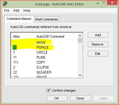

BIGAL Posted October 20, 2016 Posted October 20, 2016 My favourite is zzz or aaa. XT = extrim When testing lisps (defun c:aaa ()(load "programtest")) My osnap 39 99 123 etc but uses defuns. Cp v's 222 yeah I guess a little easier to type when using the hunt and peck typing method given distance between C & P Double tilde really smart top left, but needs shift can we use `` ? will test. Yes it does !! Quote
Dadgad Posted October 20, 2016 Posted October 20, 2016 (edited) Actually BIGAL, I called it the Tilde, but what it is, is the TILDE key, whatever the lowercase item is, not sure. Now I see, that you described what I actually have set, I misunderstood what you said, when I first read it. I don't use a shift at all, , and just slide down one key from my default ESC position and click once or twice, for MOVE, or PS. I am happier counting repeat strikes on a single key, rather than moving my hand position, or having to look for visual confirmation at the keys. I use ZZ for the DIMSPACE command, as I frequently wish to align dimensions. I have a wonderful lisp at ZZZ, which will reorient an off-axis 3D Solid to ortho, merely by selecting it. GP wrote it and posted it on the forum in 2014, it is excellent. Thanks GP! I don't use it anymore since ProSteel does all of the detailing, but I used to use it all the time, and really love it. Definitely worth keeping handy, in case I am working with plain Autocad instead of ProSteel. S is for STRETCH, SS is for SCALE, and SSS is for SELECTSIMILAR. X is EXTEND, XX is for EXPLODE, & XXX creates an XLINE. PP is PURGE, PPP is PRESSPULL. I HATE taking my hand off the mouse, it breaks my rhythm, I want the mouse driving at all times. Edited October 20, 2016 by Dadgad Quote
